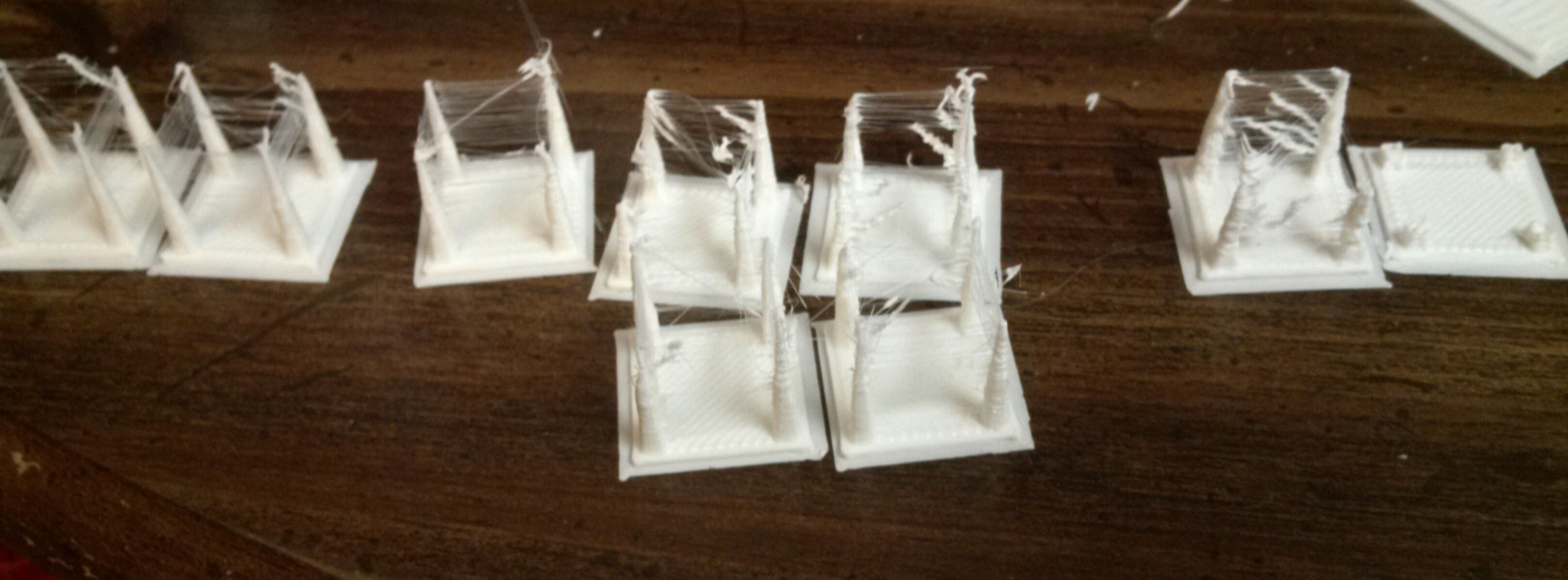

So, when retraction settings and travel speed adjustments only go so far,
So, when retraction settings and travel speed adjustments only go so far, going down as much as 3-4C causes delamination, the extruder temperature tends to bounce between -2C and +1C compared to my set temperature and I still get ultra fine hairs, I think I have my quality sadly set as well as I can. I could try 1 degree lower, but that is a delamination risk. I tried setting ‘retraction_combing = No Skin’ but I am not sure if it is valid on this old Cura that is in OctoPrint or not. The detail is improved, but the ultra fine hairs are rather hard to remove. I am thinking maybe an acetone vapor bath will fix the hairs…sorta.
For those of you that want more details, it is a non-geared (I refuse to say direct drive because of clarity reasons) cold end with bowden tube (without bowden tube has sometimes been called direct drive) with a cheap E3D knockoff hotend. I have tried 3mm,6mm,12mm retract distances at 20mm/s (once), 50mm/s (once), 100mm/s and 200mm/s and I have tried 250mm/s and 350mm/s travel speeds. I have a 1.5mm Z hop. I print at 80mm/s. I print with 225C hotend and 95C heated bed. I believe my nozzle is 0.5mm. This picture has 3mm retract on the left, 6mm in the middle and 12 on the right. Within the sets, I tried to have slower retraction to the left and faster retraction on the right.

Combing does nothing in this example. In another test piece that I did, the combing left a scar on the side of a print where it sucked the filament in towards the center of the object.

That seems like it may be an improvement. The donut shape is slightly distorted, but less than the previous attempt. I think the bed temperature was too high. I am unsure of putting the hot end above 230C with a PTFE liner in it, but I think I will try 85C for the bed.
85C also stuck well enough.
nice, and looks better. I also use PTFE-lined throats and haven’t had them burn out yet from overheating but I also havent exceeded 245.
The strings are still their, but they are reduced.
