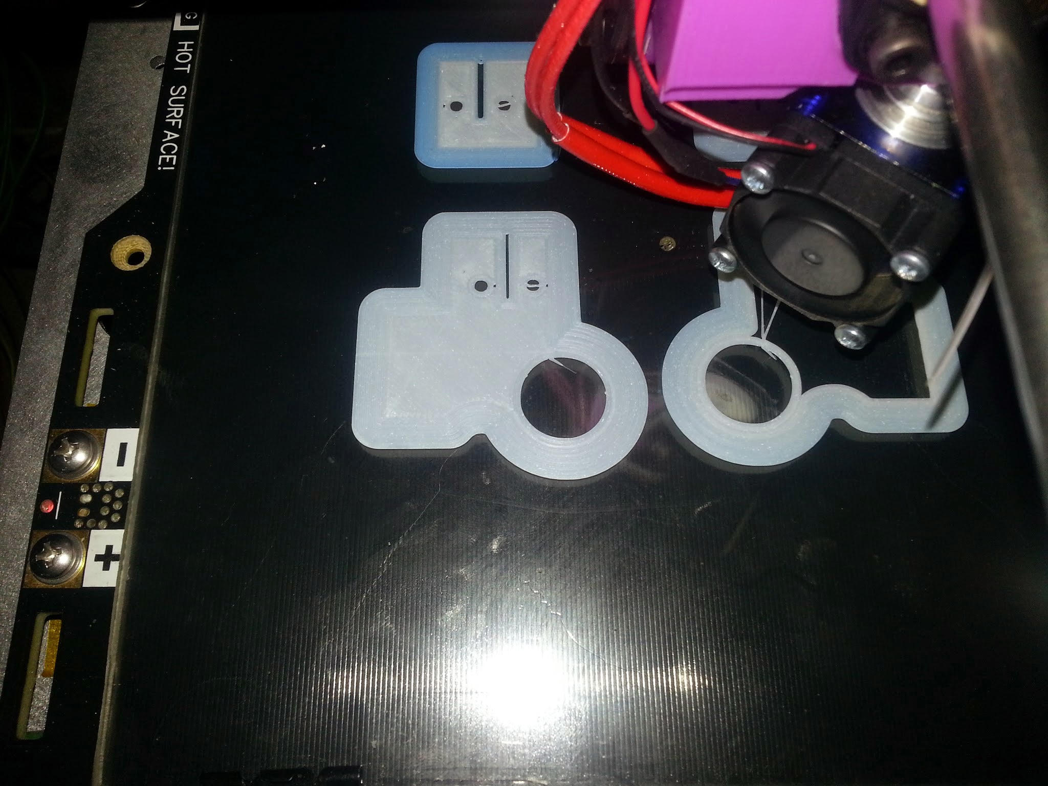

So, yesterday I had to apply excessive force to try and increase the tension in my gt2 belts, but the test circles still failed to print properly so I decided to print some of @Eclsnowman 's parts, after @Miguel_Sanchez suggested that I might have to get rid of the igus bearings. Here you can see that I just started the print, but also, that those circles suddenly look almost perfect. I may have to do some more research into what’s going on.
Maybe alignment of bearings was not good and it is getting better after some use? Did you perform any type of mechanincal run-in?
I did a 5 hour run of a spiral vase, but it probably wasn’t enough. I’ve also replaced some shafts which I assume undid any previous run-ins.

I do suggest making a “break in” g-code and running it for a few hours. Travel to all four corners in a box, then cross over the center going corner to corner. Repeat. Repeat. Repeat…
You can add z travel codes to break in the z stage too.
It really helps to smooth things out. I am pretty sure this is what I used. Just edit travel distances to match your printer usable bed sizes. https://docs.google.com/file/d/0B1rU7sHY9d8qcVYwUmhBYzBJOUk/edit?usp=docslist_api
