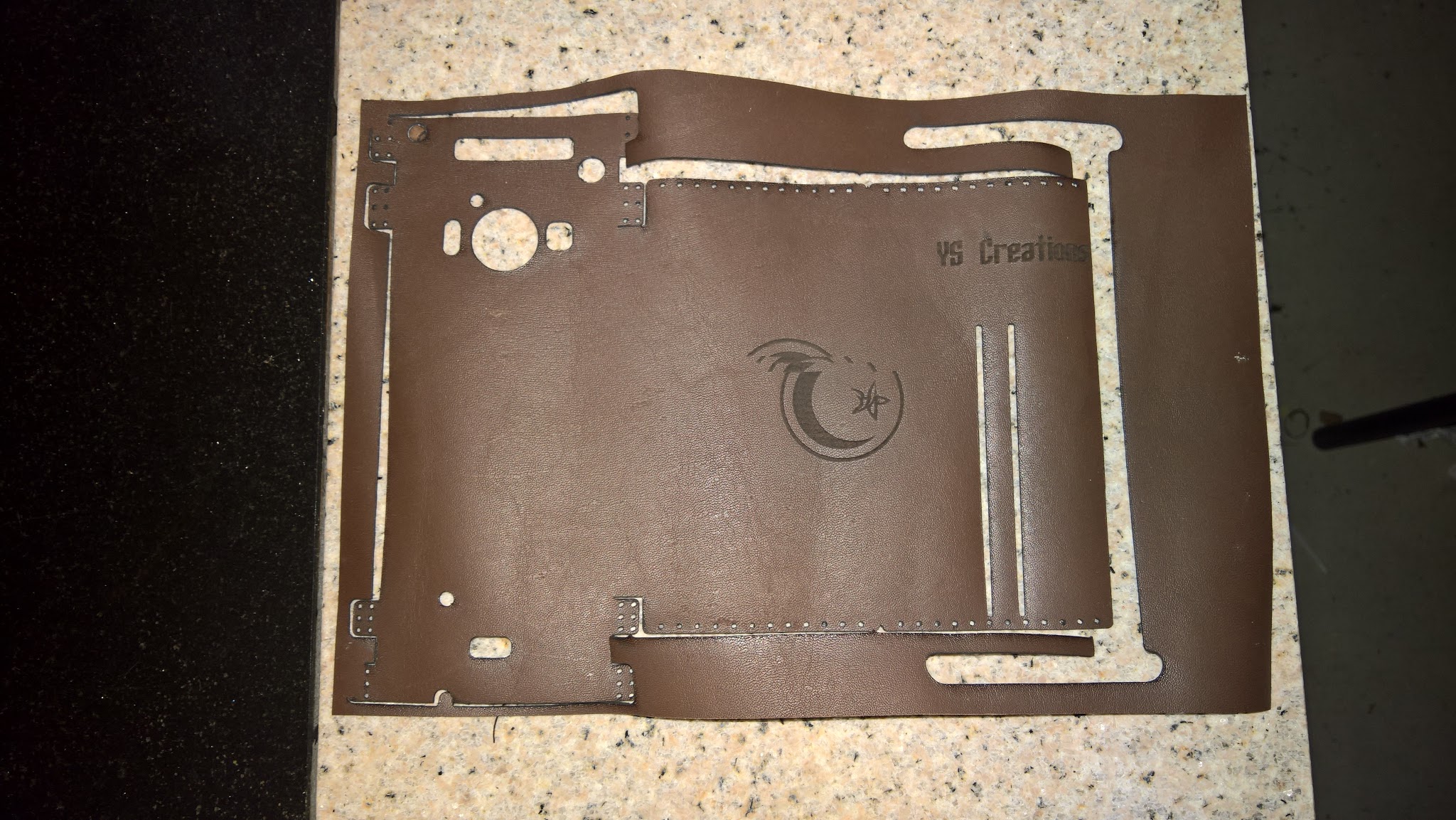

So yesterday when I was engraving some leather for the phone case I came across an issue with my machine. If you notice my logo in centre seems to have slipped or something to the right twice during the engrave. It actually happened on 2 pieces of leather on 2 separate attempts. At the exact same spot on the engrave also. Nothing odd seems to happen when I am cutting at this point, so I’m wondering is this a software or hardware issue? Any suggestions what to look at to fix this?
I’ve had similar issues on certain files, seems like there has been some sort of corruption in the file data. Looks fine in corel, but skips at a certain points. I’d reimport your logo and see if that fixes things.

Looks like missing steps (a lot of them). Look for loose pulleys, loose belt, missing belt teeth, and that sort of thing in the X axis. Binding of the head from bad rollers, guides, and idlers will do it too. Make sure the Axis moves smooth and easily with the power off.
It could also be an intermittent electrical connection in the X stepper motor wiring, like loose connector, fatigued "flat’ cable or anything else that would generate loss of continuity in the 4 motor connections.
Lastly, if you’re running on the edge of too fast, as it runs, heat will reduce the stepper motor torque (due to reduction of the power supply and motor capacity) and cause it to “cross the line” and start loosing steps.
The one big disadvantage to steppers is they have no feedback so there’s no alarm or correction if they are interfered with, or fail. The controller just keeps going ahead as if nothing happened.
