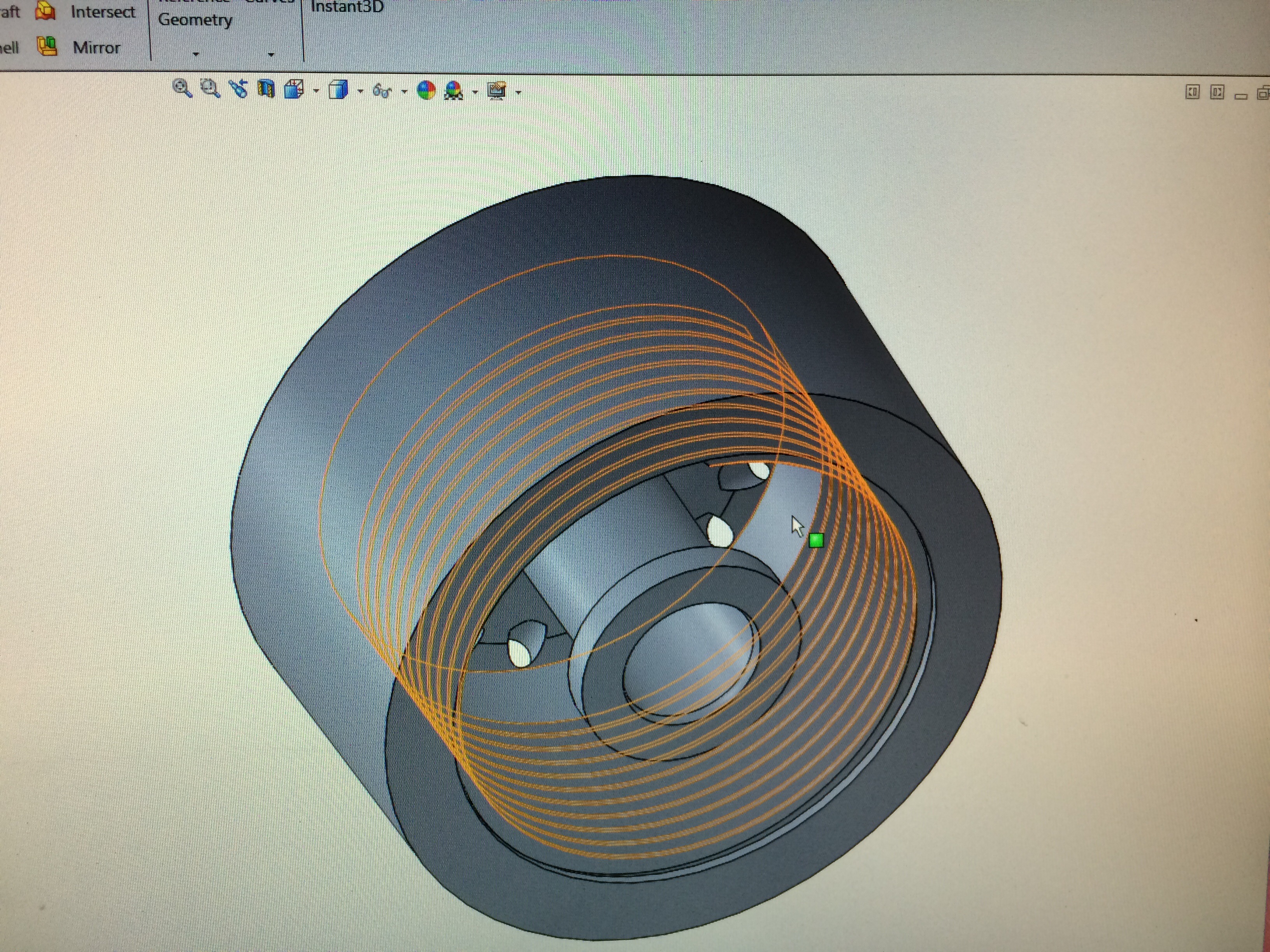

Solidworks and 3d printing a perfect match. Test fitting my pitch.
Custom pond water jet system. Sits water level, when pressure applied 45, 60, and 90 degree from horizontal jets pop up.
Hmmm now possibly some LEDS…:slight_smile:
Do you have any pics with water coming out? Would love to see that.
When I checked, the student versions did not allow you to share the work you did on the discounted (student) version.
So I’ve steered away from using SoldWorks if I’m going to share the model in any way. If others have done the same, that might be part of the reason there are so few sld* files in the wild.
you can share student work, you just can’t use it for commercial purposes. And the files remind you of this every damn time you open them.
@Brandon_Heller anticipate having photos or video shortly, just handed the hardware off to the requestor.
To the remainder of comments. Can you not save the file as an STL and share? I’m not on a student version.
Let me see, and post the fountain head in action and I will gladly share! If it cannot handle the flow rate, I have failed and not worth sharing. :slight_smile:
@Shauki your are correct the file would be machine dependent. These threads ran at 180 on a finally tuned machine, would not match results of 210 on slop.
