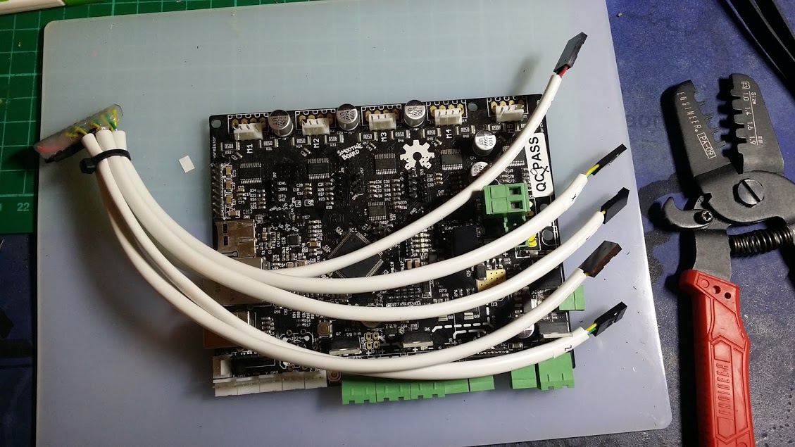

[solved] I am trying to retrofit a Smoothieboard v1.0b to a CNC3040Z CNC. I kept the TB6560 drivers and just made a cable for the dir/step/spindle/probe/estop signals. It plugs onto a 2x13 pin header that I soldered on the existing board, which simply match the signals of the parallel port (I did check more than once of course).
But I am having hard times with the config despite the nice doc.
The web server was up and OK with my old coreXY config & firmware. But I had no step signals (checked on my scope). I thought it could be due to a misconfiguration that triggered a protection meant for 3D printers (e.g. thermal protections etc). I then made lots of modifications (disabling all temps, extruders and heaters just in case), but probably screwed the config (fast blink on led 2 & 3, the other stay on).
I am using the latest “cnc” firmware. The web server fails to open, though I see my usual IP in the LAN.
