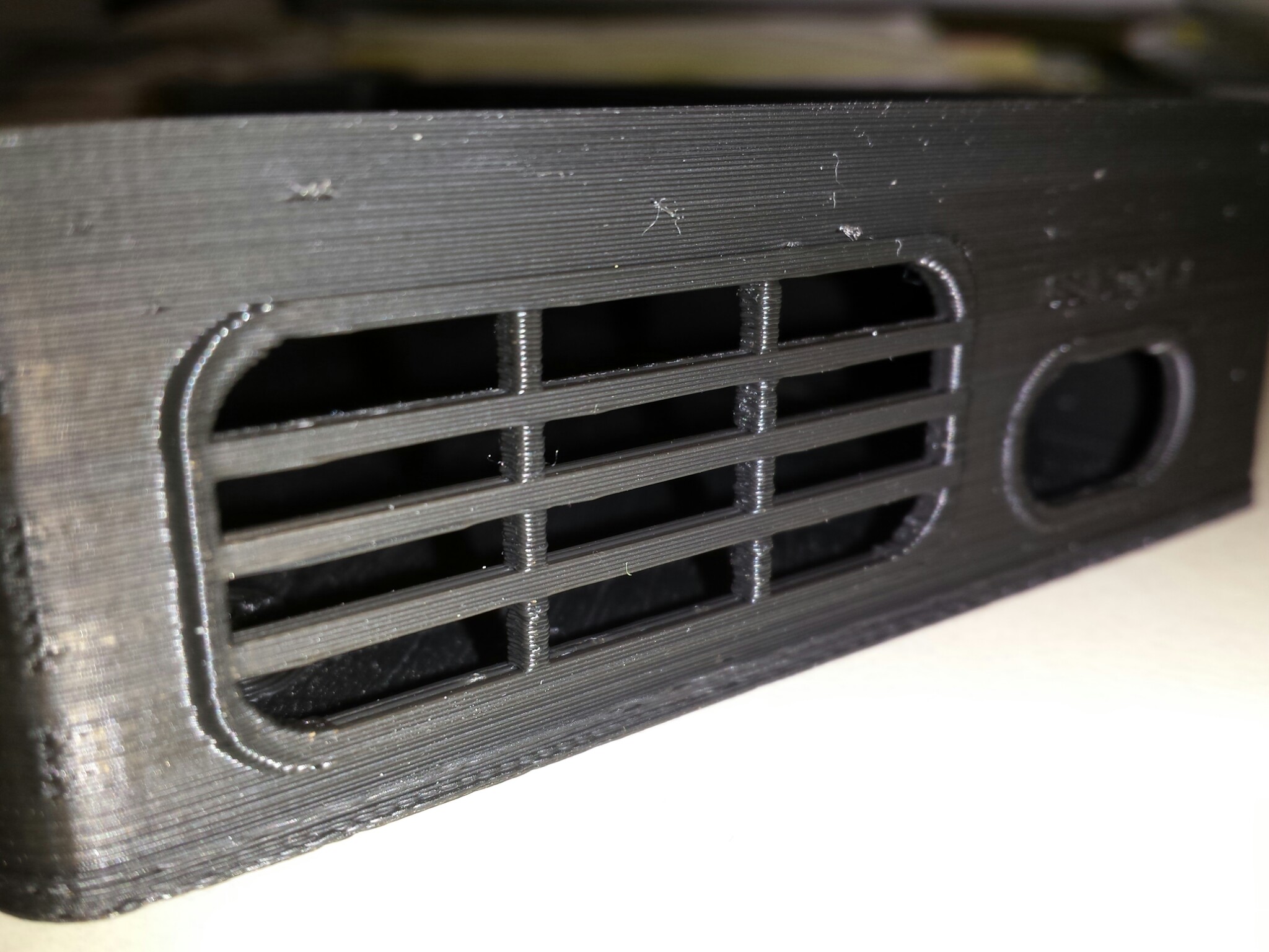

Some close-ups of the second iteration of the project box.
Some close-ups of the second iteration of the project box. I only had time to print the bottom last night. :stuck_out_tongue: I adjusted the lip around the edge and dropped the extrusion temperature for printing with black PLA. I will say I am particularly proud of the grill on this part as the vertical and horizontal bars are only 1.5mm in width and they turned out really well with no sag! Tonight I will print the top. :slight_smile:
do you have active cooling going on for the bridging?
Yep, two 40mm fans on the carriage running at 100%.
Very nice work. I hope to get my printer dialed in that well!
The grills really do look great. Congrats.
Very nice! What slicer did you use?
I used Cura for these parts.
