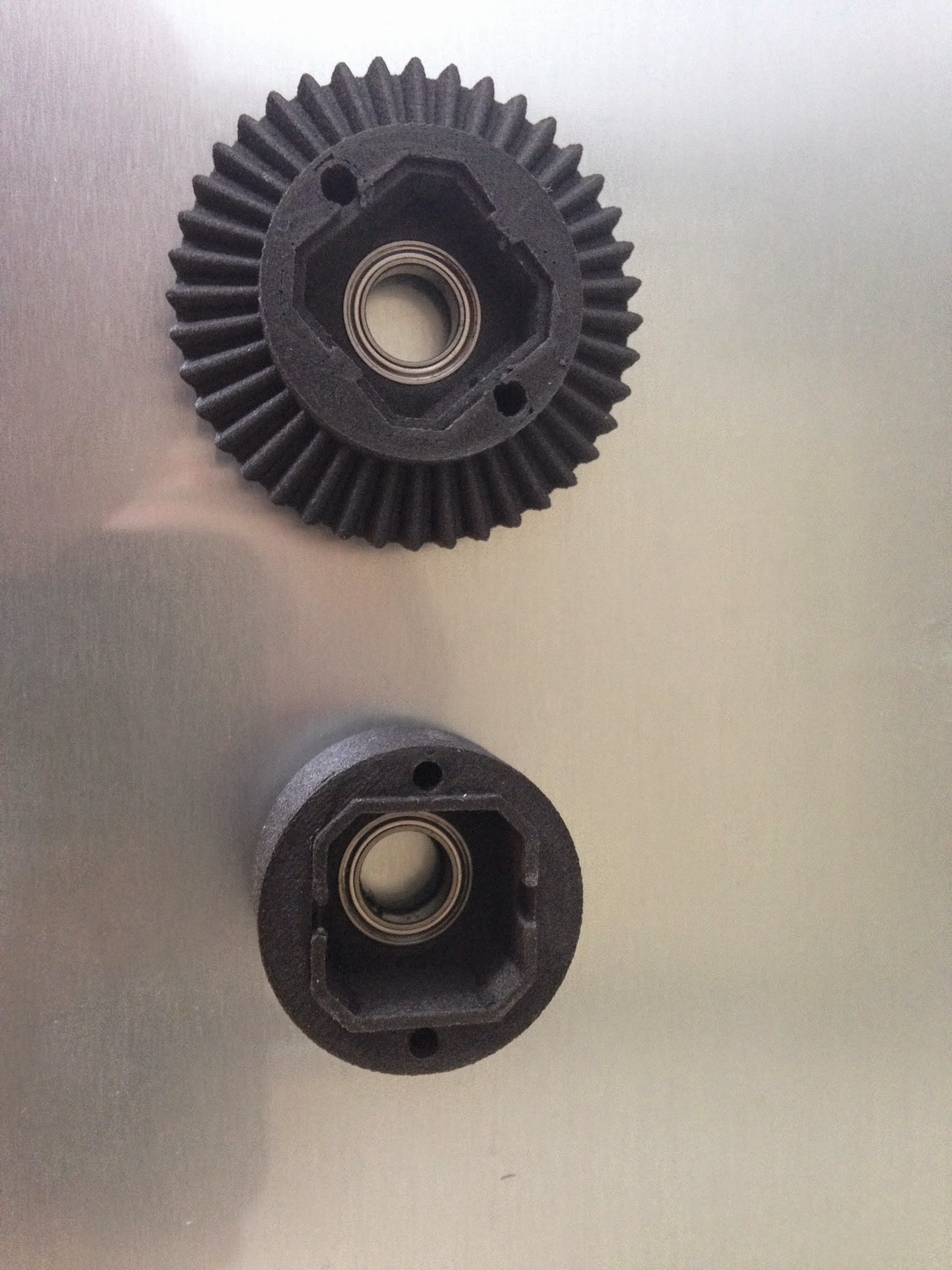

Some impressions. I did a lot of modification as example using bearing inside differential,
Some impressions. I did a lot of modification as example using bearing inside differential, wider cases a so on.
The Care were printed with many different material for testing reason. The gears where printed with reinforced carbon material and also bridge nylon from tulman3d. Absolut great material  thanks a lot they guys they develop that kind of great material.
Looks great Frank! What carbon filament did you use? What are you printing with? Your prints look fantastic.
hey Adam thanks for comment!
I used the carbon filament from http://www.proto-pasta.com it’s realy one of the best filament that I ever used. Easy to print wiht a great looking result. I did printed with a ultimaker 2 the gears with a layer high of 0.05 / 210C / 50mm.

Have you some feedback about the resistance of you carbone print on a running car ? can you compare to ABS or else ?
