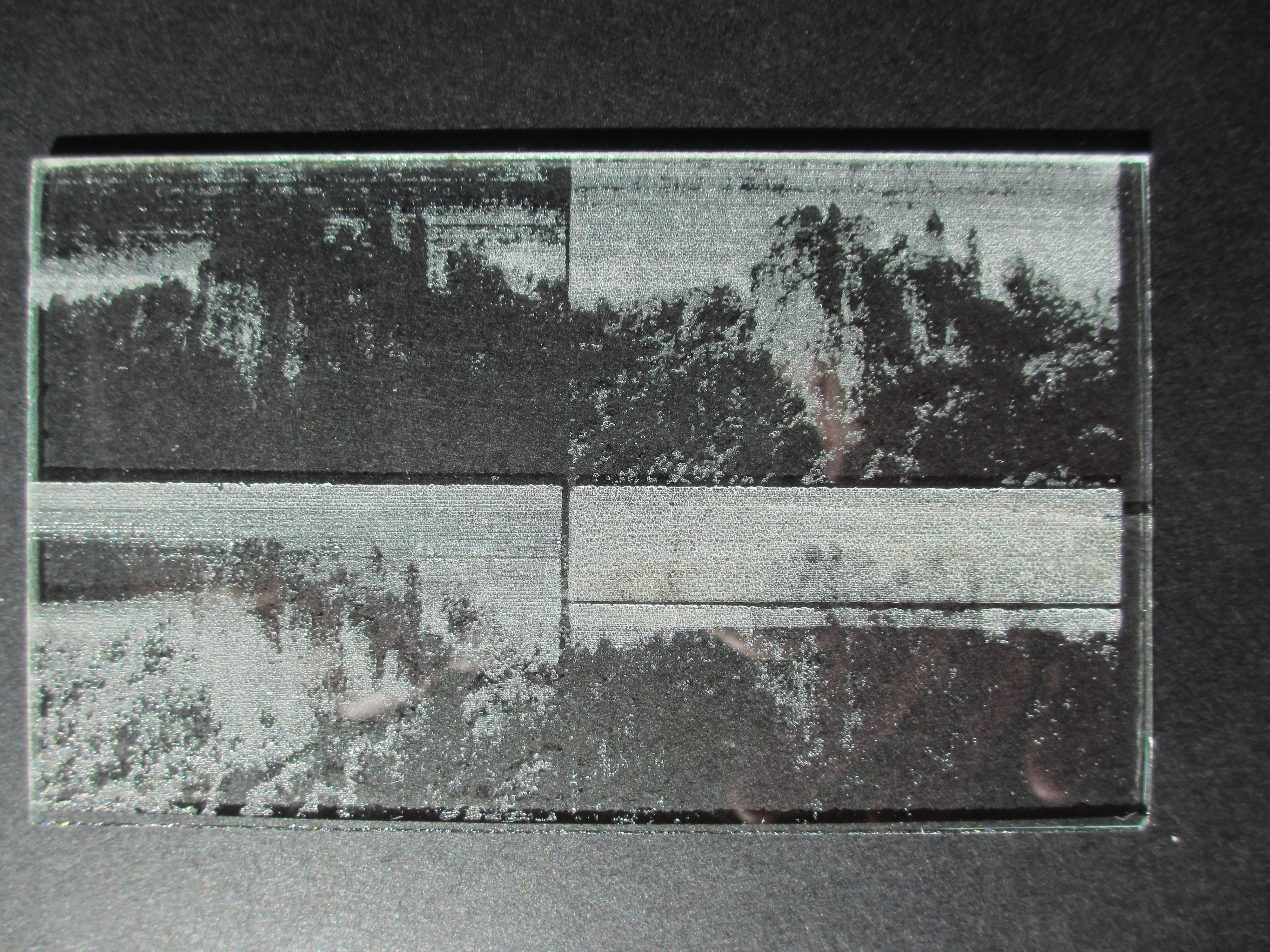

Some more imperfect attempts at doing grayscale direct from LaserDRW using the "pixels" parameter,
Some more imperfect attempts at doing grayscale direct from LaserDRW using the “pixels” parameter, and was done with 2 layers of wet newspaper.
Upper Left is 100mm/s, 10ma, pixels 3 steps
Upper RIght is 100mm/s, 15 ma, pixels 3 steps
Lower Left is 66mm/s, 12ma, pixels 4 steps (probably shouldn’t have changed from 3…)
Lower Right is 66mm/s, 12ma, pixels 5 steps. The paper was getting try and starting to flame up, so I paused and resprayed the paper. The gap is when I bumped it testing how dry the paper was.
The second picture is the original, a grayscale conversion of pic of Bled Castle in Slovenia.
It cools the glass and prevents cracking (tested that :slight_smile: ), without anything the glass will crack). Another technique is to buy laser masking paper, but it’s spendy. Some use liquid dish soap; haven’t tried that yet.
I forgot to invert the photo and show the back side of the glass, but these are just to try and beat the software in to submission and get the right speed and power settings.
Just wet paper, no other treatment on the glass?
Also, what exactly is the “pixels” parameter … what does it do? I’m assuming the ‘repeat’ is just how many times it will repeat the whole engraving process.
@Ashley_M_Kirchner_No Just newspaper and water. I’ve also used copier paper, works just as well. I think the paper sucks up too much power and isn’t consistent, but maybe it’s operator error. I read that cheap soda glass works best, can’t get much cheaper than broken windows, as long as you replace the busted panes first :slight_smile:
As far as I can tell the “pixels” parameter will take a pixel by pixel sized block, average the black intensity, then turn on (fire or not, depending on “invert”) the laser for enough pixels to make the average intensity of the engraved block match the picture. For example, if it’s 50% gray then it’ll hit half the dots. It’s called halftone or dithering. Since you can only make a dot that’s on or off you make enough small dots so your eye sees the average thinks it’s a shade of gray.
