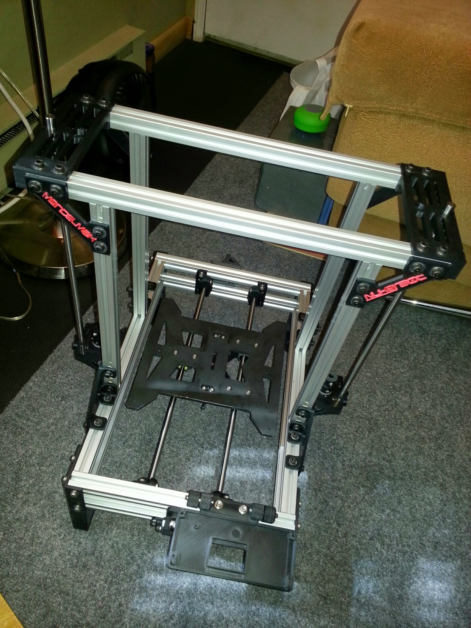

Some more progress on my Mendel ZXT
That’s a nice machine you have there. Is it a kit or did you source it yourself?
Thanks @Steven_North It is a clone of my current machine, a modified Mendelmax 1.5, I made a few custom parts for the conversion, I will have the completed files on my website soon.
My site is still under construction at http://nukerbot.com. The extrusions are Misumi 20x20mm and the Rods are 8mm for X and Y and 10mm for the Z. The bed is my own design CNCed out of Dibond.
