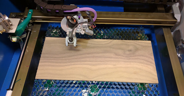

Some more upgrades for my K40 Now that MKS SBASE is working good,
Now that MKS SBASE is working good, I decided its time to get some mesh material. this is 0.008" thick aluminum mesh by 1/2" tall. was cheap on ebay. I later found out the seller would custom cut a size. so I will be going back for a larger piece.
also 3d printed some cones to support the mesh at the proper focal point for cutting 1/8" material
also relocated my optical Y-Endstop so that my machine homes to 0,0 bottom left corner ( I understand I could have set this to happen in the config file, but the hardware solution seemed easy and legit)
Bought the air assist head and the improved 18mm lens from LightObjects. as stated before this head is sharp lol no I mean really sharp. they did not deburr it at all lol. no prob for the low price.
now I need to re-align my optics because I am getting heavy ghosting on the far right side of the bed. Crap I may have cracked my new lens ! I hope it’s just out of alignment and reflecting off the bottom of the air cone… I’ll check it tonight.
this is just a random kind of post, I want to update you guys on my build so far.
driving the steppers 1/32 really quiets down the machine and makes it seem a lot smoother.

@greg_greene I’m not sure if the cones are the right solution yet. I shaped them like a pyramid so they are stable, I also had to add metal tape to the tops because PLA smells nasty when hit by a laser beam lol
@greg_greene You can buy them at paint & craft stores - they’re called paint standoffs.
