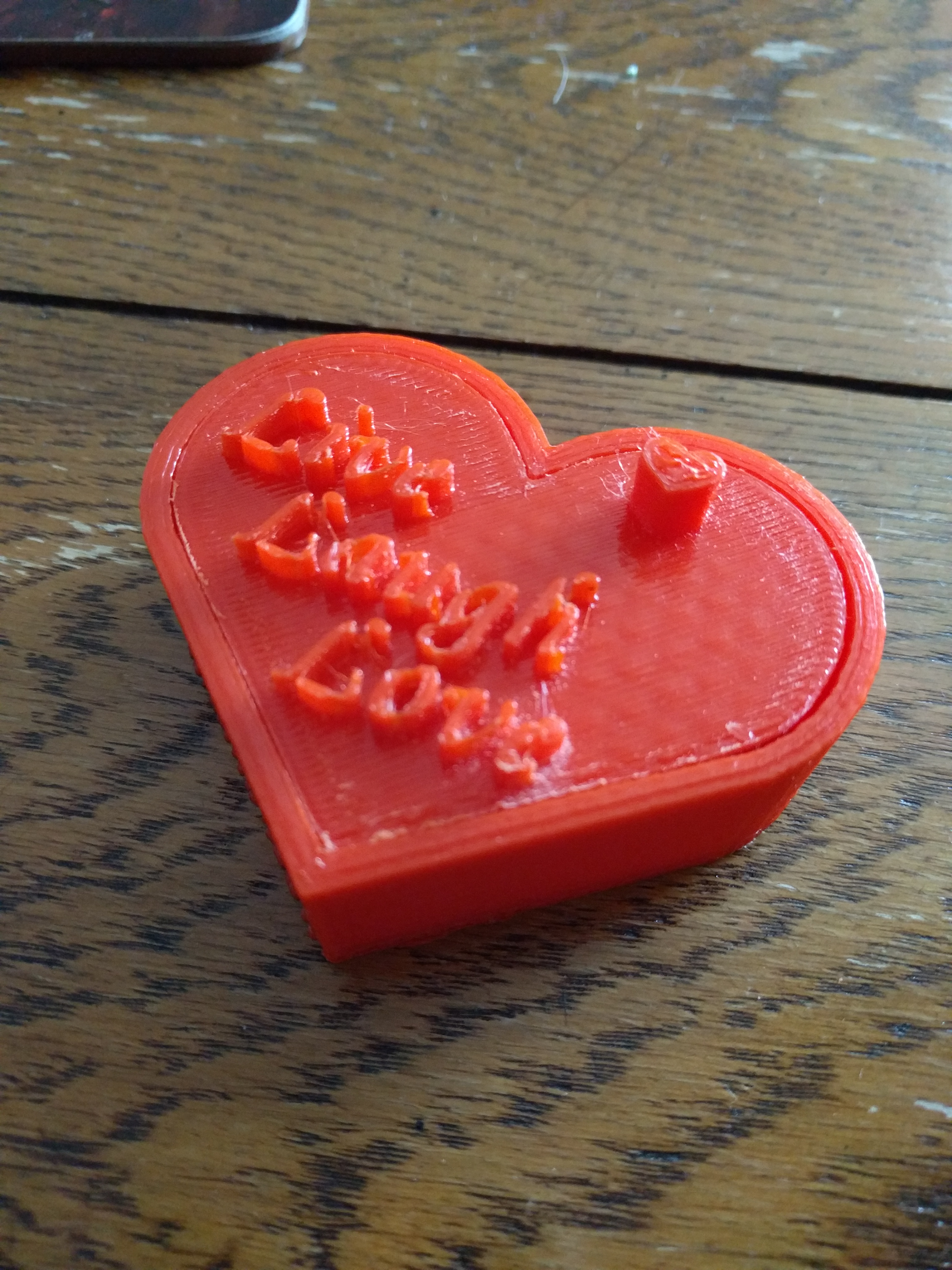

Some new prints
http://www.thingiverse.com/thing:69922 and
http://www.thingiverse.com/thing:1212026
pigs feet messed up a bit, ill have to figure that out
Some new prints
Nice. Looks like you have a bit of a overheating problems with the slimmer/smaller parts.
@Anton_Fosselius ya im doing PLA at 205. think ill drop it to 200
And perhaps print several at once? Always a good trick for allowing the layers to cool between hot-end visits.
@Mark_Wheadon I just noticed my cooling fan isn’t kicking on after the first layer. If I tap it with my finger it starts. Order replacement hopefully that helps
Ah that would do it!
