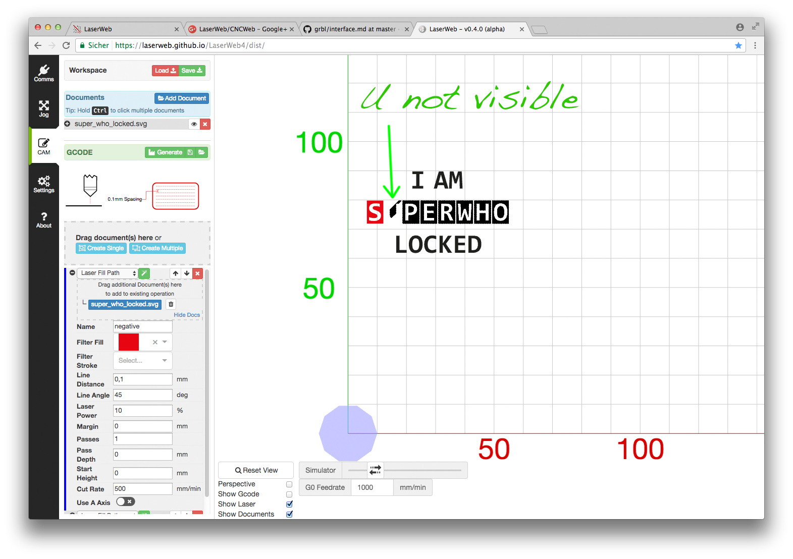

  1. Why are some objects not visible in LW4? Path is closed, I touched all anchor points!

Workaround for polytri bug is now in place.

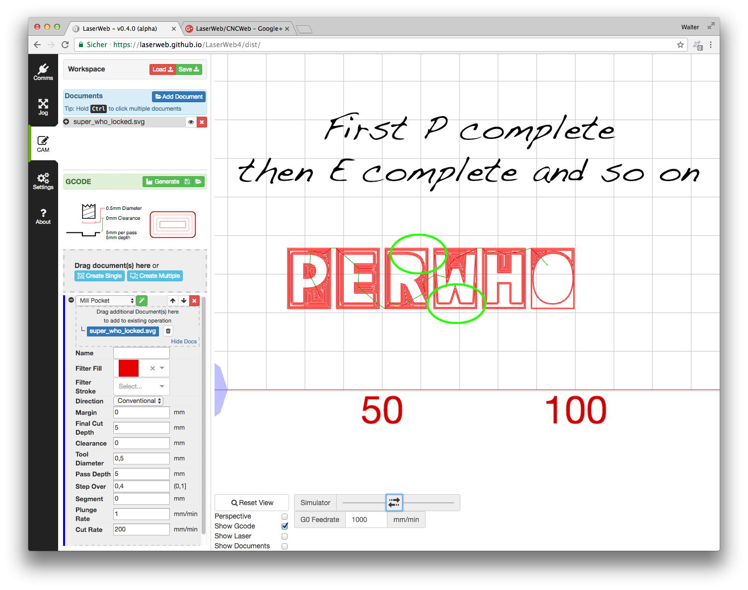

I tried Mill Pocked (just for seeing what happens). I think it should work on an entire object and then move to the next.
At the moment I looks like a random order!
If you want it to do one object at a time, then create a separate operation for each object. cam-gcode combines paths into a single compound path then operates on the whole. It uses a greedy optimization algorithm to order the result.
