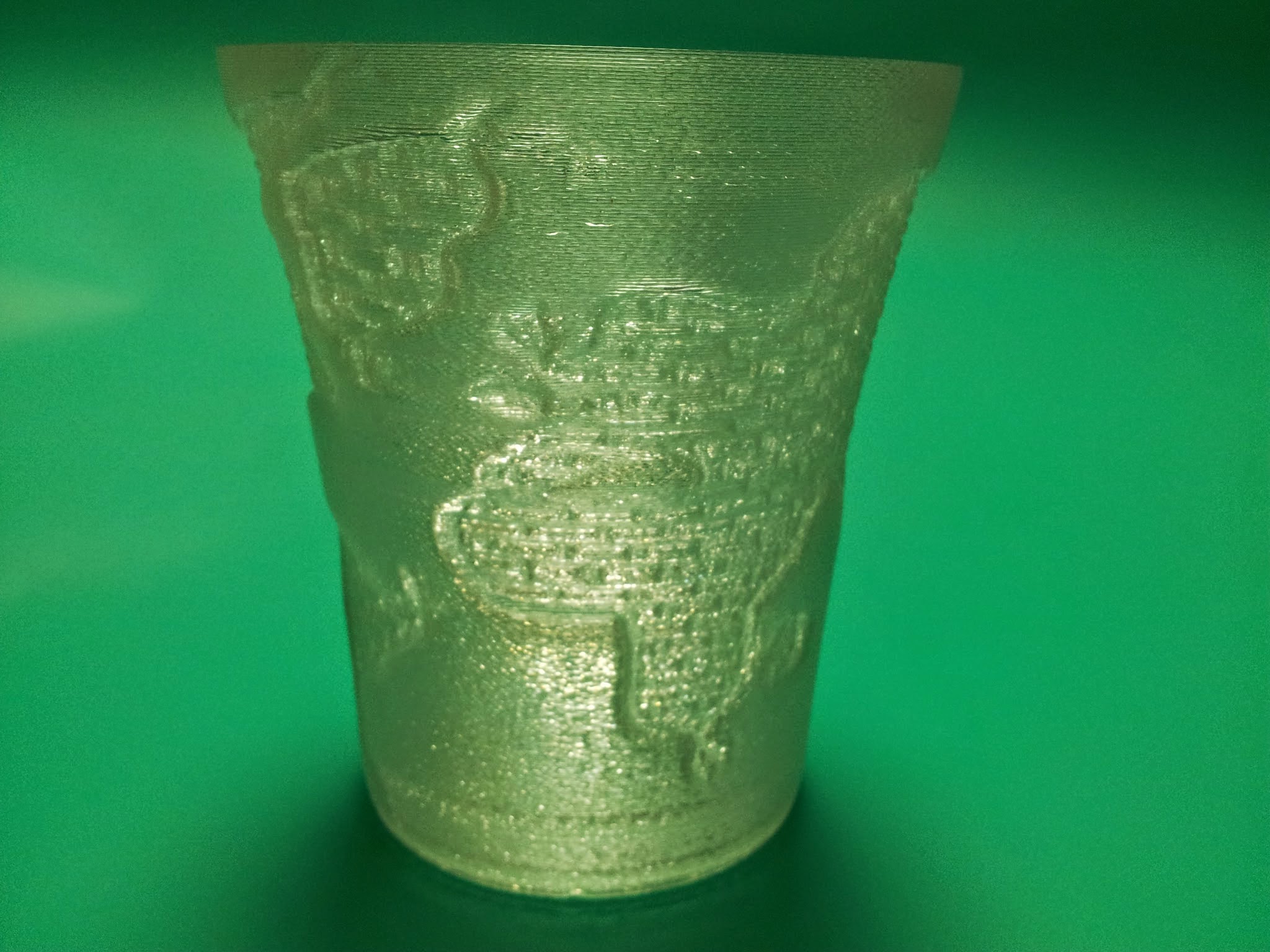

Some recent tries with E3D hotend and not so common materials. Ive finally got some time to try out the PET from http://www.plastic2print.com/eu/ and it looks wery interesting, very easy to print, good bonding and I think one can achieve nice lightning effects with this one. It comes in 0,5kg spool, completly transparent, but as you can see extrusion makes it look frosted, witch I think makes it look really cool. The other material Ive been working quite a lot these days is nylon 618, it has really wonderfull mechanical properties, and we find it perfect for rope tensioners we use on our gangways http://www.carbonautica.com
