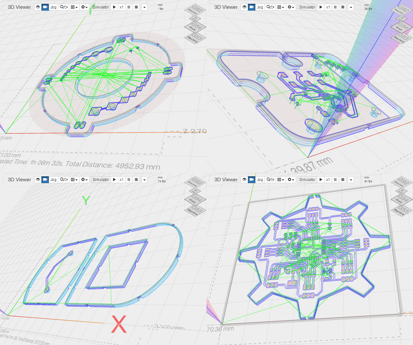

Some samples from upcoming version of Eagle BRD widget, I added lots of features, I feel like I need to write a user guide to explain all of them, here are the main ones:
Tabs (Board holders) … works with G1, G2 and G3.
Support layer 46 - Milling.
Vias & Pads are rendered accurately based or Resting parameters.
GCode Tab rearranged in multiple tabs.
Milling board dimensions with multiple tools based on wire width.
You can check the new features on http://www.chilipeppr.com/ameen
I still have few things to do before merging this update with main project.
Three of the boards in the screenshots are not real designs, I just made them to test my code, the forth one is a sample I downloaded from http://cirqoid.com, this board gave me the idea of using layer 46 and open dimension paths.
I’m designing a board to use as a show case for all new updates/features.
Send me the brd file when you like it so I can add it as a sample brd in the file load menu because I think it’s worth having a board like that for folks to load and play with to see how cool the widget is now.
