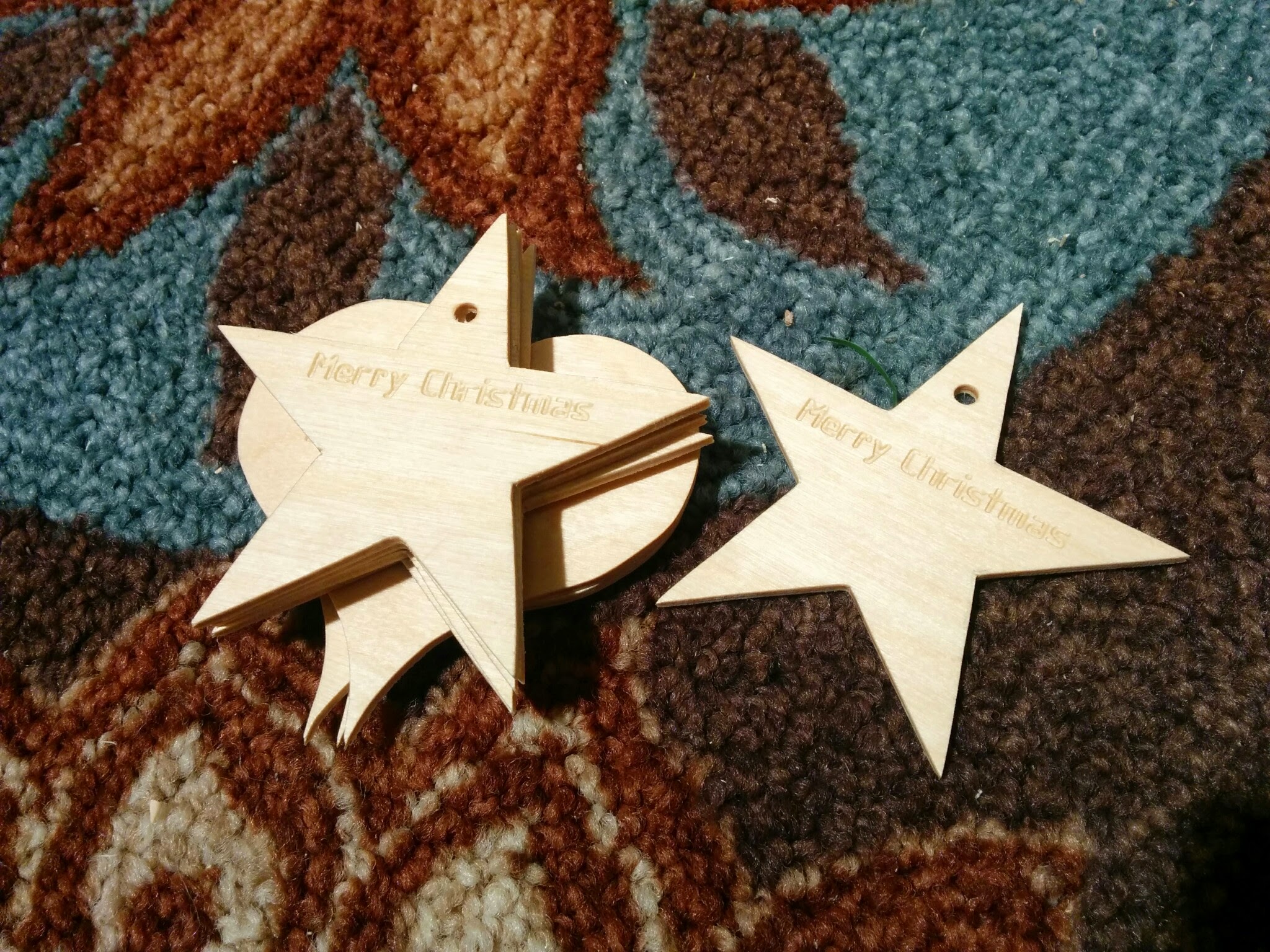

Some simple  Christmas ornaments made for a client.
Some simple shapeoko Christmas ornaments made for a client. All of them are 1/8" thick plywood. The black one is 1/8" thick black acrylic.
F-Engraved with a 60deg v-bit at 0.02" deep.
Wow. These engraving looks really really smooth. Can I know how long such an engraving take per piece?
The engraving was not long at all… maybe a minute and a half for the most parts.
The smoothness comes from the slight bit of sanding done afterwards and like @Steve_Ramsey says “I’ll finish it with a few coats of spray lacquer”
