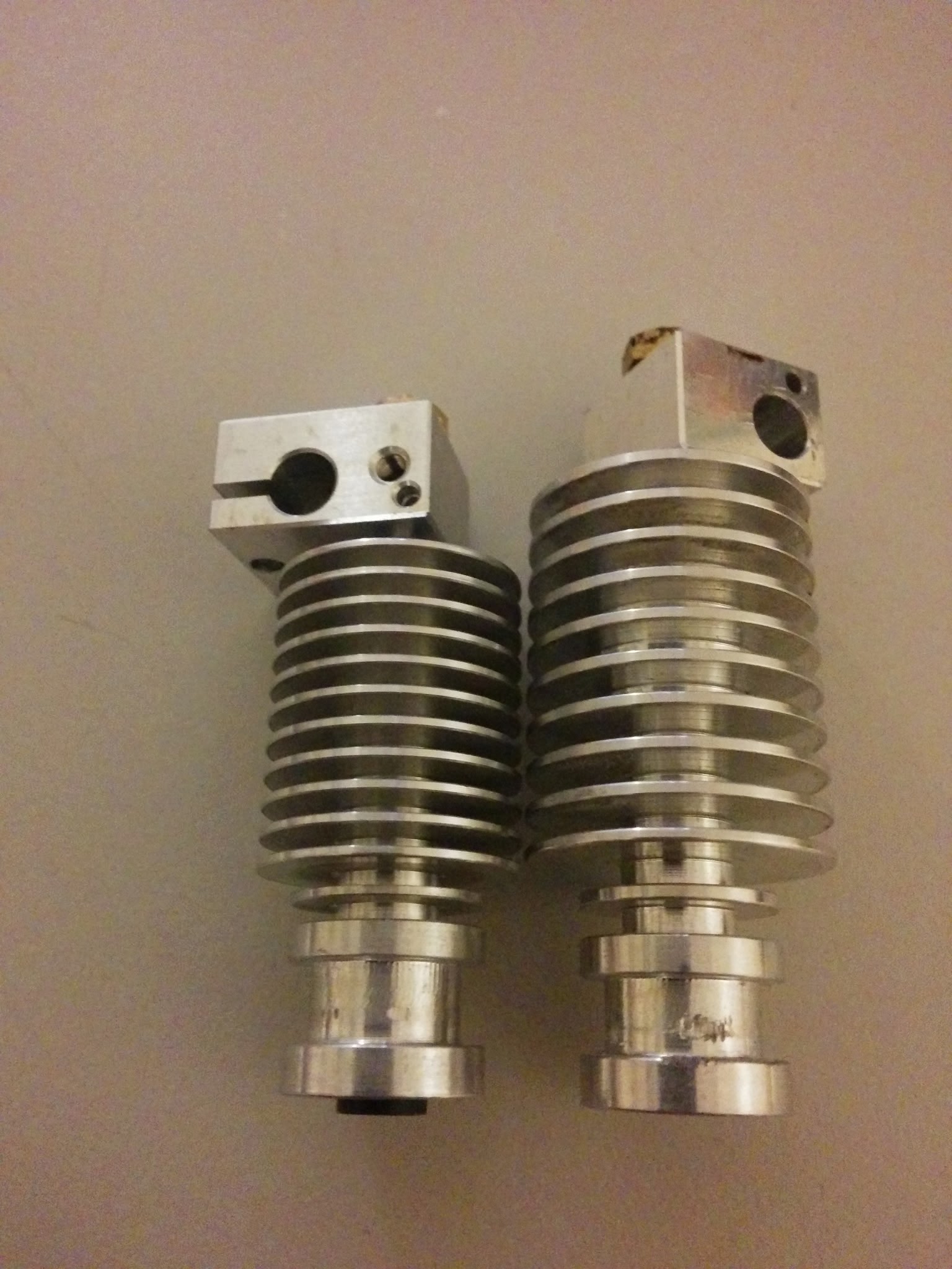

Some size comparisons of the E3D v5 and E3D v6 hot ends before I swap mine out. I am impressed with the difference in size. Hence the photos :stuck_out_tongue:

Anyone know the weight difference between them?
@Matthew_Satterlee the metal parts are about 10g lighter than the v5 and about 7.5mm shorter.
Thanks @Thomas_Sanladerer !.. I’m trying to decide if I should get the v5 on sale or spend a little more on the v6. :slight_smile:
@Matthew_Satterlee i’d get the v6, even if it was just for the clamped thermistor. But you also get the new heat break, the molded fan shroud, the new Kraken-style bowden coupler and 7.5mm of print height with the v6, so i think it’s a pretty easy choice. Not that the v5 was a bad hotend, but the v6 is just plain better.

The heat sink is a turned aluminum, made with something like a parting tool - if you’re careful, you should be able to make a functionally identical one on any lathe. Some hotends also use modified off the shelf heatsinks or machined t-slot aluminum (Deezmaker).
But the trick really is the heat break / insulation, using a piece of stainless steel turned down to a small cross-sectional area keeps heat from creeping up in the first place. The E3D uses a 40W heater, but only uses a small fraction of that power once it’s heated up.
