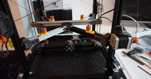

Some updates to #zsplat, photos also show a new QR build (called #RickDangerous cauz i drilled into my finger when doing the QR holes in my kitchen … … …). +MakerGal #GSlot profiles and wheels

Any reason for not using the alu vertical members as linear guides? You might be interested in #Miltykoss build by #AlohaMilton for some linear guide ideas. I believe his approach should also be tried on corexy printers. Anyway congrats for the very clean build.

@Florian_Ford thanks for the tip. could be done as well but i can’t see a direct benefit. my setup is more or less invariant to small changes in the cross bar length. thus, might be easier to setup. i have however another idea which coincidentally is even more similar to your link.
i hope you manage to finish your build soon. i build 2 corexy’s before but having done the QR i find it superior in almost every respect (relative to my own custom builds of course)
I know Prusas have lots of issues due to having always to manage 2 motors to drive the Z axis. I am wondering about the 2 motors per X and Y axes in #Quadrap-3d-printer aren’t they getting out of sync to make the moving rod a tad skewed and to influence the dimensional accuracy of the print? Also I see you use string exclusively, when that walks on the motor coupler/winch, isn’t the minute change in length translating to the part in a change of the printed dimensions? I am just wondering cause I’ve been an ardent supporter of spectra drives but different people around the net have made measurements and almost always the “walking” was influencing the end result. Of course the shorter the distance the moving rod travels the less walking => better part. Sorry for too much talking :).

@Florian_Ford i had the same thoughts initially motors do not seem to get out of sync (compared to other printers they stay at room temperature due to very low resistance/weight applied to them). even toothed belts have tolerances and i doubt that the cheap pulleys used do any better. anyhow, all the others here should have more experience than me. pro dyneema is less noise and price. my cheapqr outperforms my i3 mk2 original. all black/grey parts were printed on it. but i do not want to talk you into something

i like the qr frame construction most. damn robust. no expensive corner brackets/cubes. if you are uncertain but have some profiles lying in the attic just build one of the xy gantries and test for yourself. this is what i did with the motedis profiles… i think the prusa’s fail not because of the dual z motors but because of several other reasons (if they fail at all of course): unstable z “sheet”, fix mounted heat bed, massive x wagon, inductive sensor for bed levelling (can’t do it manually any more…), on the wobbly z sheet sits usually a spool holder, … nevertheless you can get fine prints out of it.

@shauki @Eclsnowman @Florian_Ford it is much more easy do get the corexy gantry wrong than getting a qr setting “wrong”. especially if you design from scratch. i don’t like that you have 2 different masses to accel on corexy. y the full carriage and x only the slider. what made me finally decide for @Michael_Memeteau 's printer as base were the onshape CAD files.

@Florian_Ford my main “problem” was having the belt tension right. if it is not equalizing your gantry is basically not perpendicular and thus your (linear) bearings are braking => you get ugly vibrations at certain movements. regarding accel: try it for yourself and see how well it is going, just push it. of course there are corexy designs using wheels instead of bearings. i’m done with it, part to my lack of skills and because i found a better solution for /ME.
i’m sure if you could see a QR in rl action you would trash your own design same way as i did.
