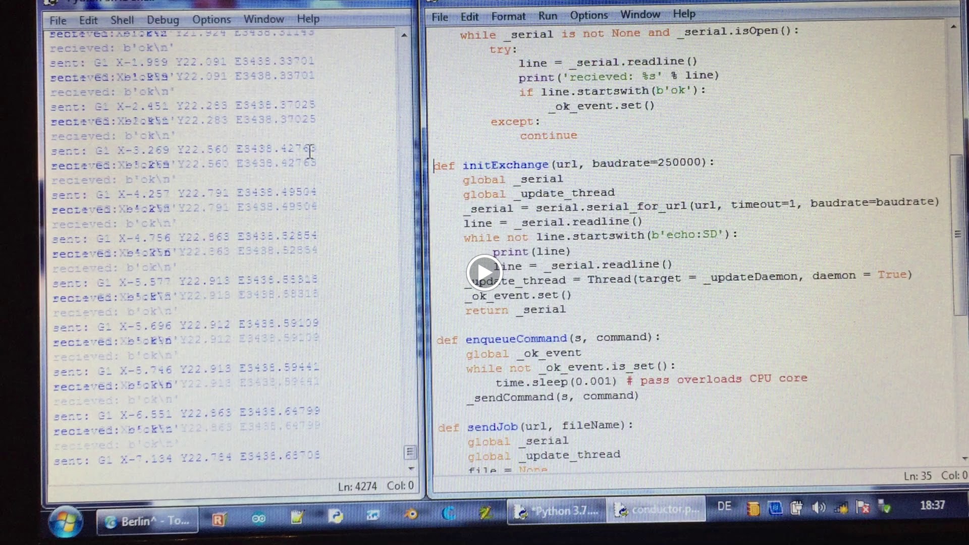

Someone of you may be positively surprised how simple it is to stream GCode to the printer. Here I have made a single screenshot code that does it.
I would appreciate your suggestions on running it concurrent for several printers. For your comments to live longer please comment on the blog instead of this G+ post that is going to die soon.

I need an alternative to sleep(sec) because the way this code is written loads the CPU core 100% which reduces printing speed. Adding sleep(1) also reduces print speed. Need a better way for checking _command_received.is_set() please.

Thanks gentlemen. Please notice:
while not _ok_event.is_set():
time.sleep(1) # pass overloads CPU core
The loop in the updateDaemon does not overload.
What actually I need is a sleep of milliseconds, not seconds.
My bad: “The argument may be a floating point number to indicate a more precise sleep time” so sleep(0.01) should work. To be tasted later

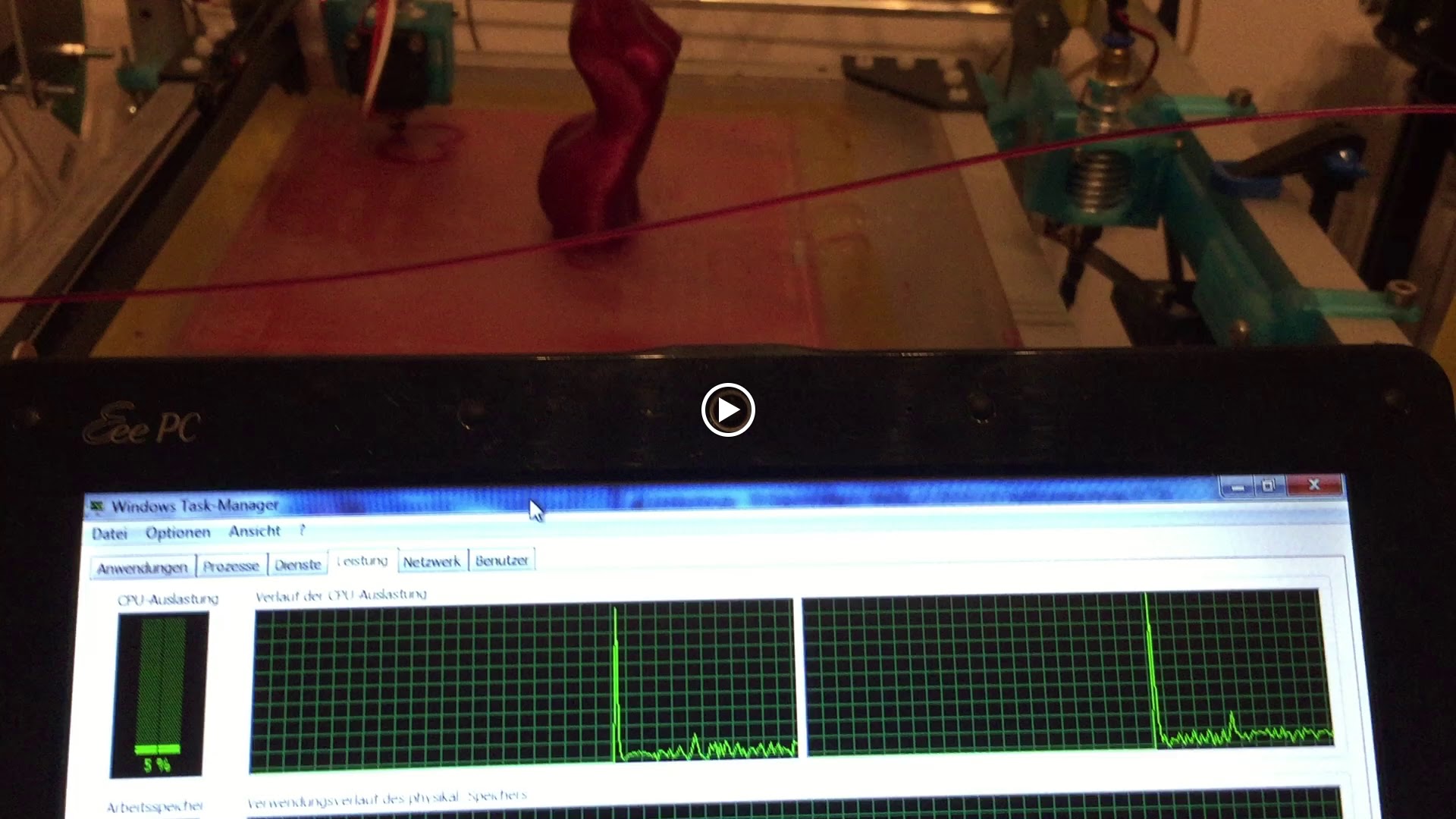

Thanks Craig! The prior print job finished in 3:30 compared to SD 2:35. It was with 0.001 sleep and print to screen. Now 0.01 sleep without print output and things look and sound much better:
I was wondering how changing from 0.001 sleep time to 0.01 sleep time made it perform better and then I realized that you removed a print statement. Yeah. opening up the console and printing a little bit of text is for some reason a performance hog. I don’t know…maybe they need to change console interaction to a separate thread or something in Python. It is mind boggling that it would be that slow at printing text.
