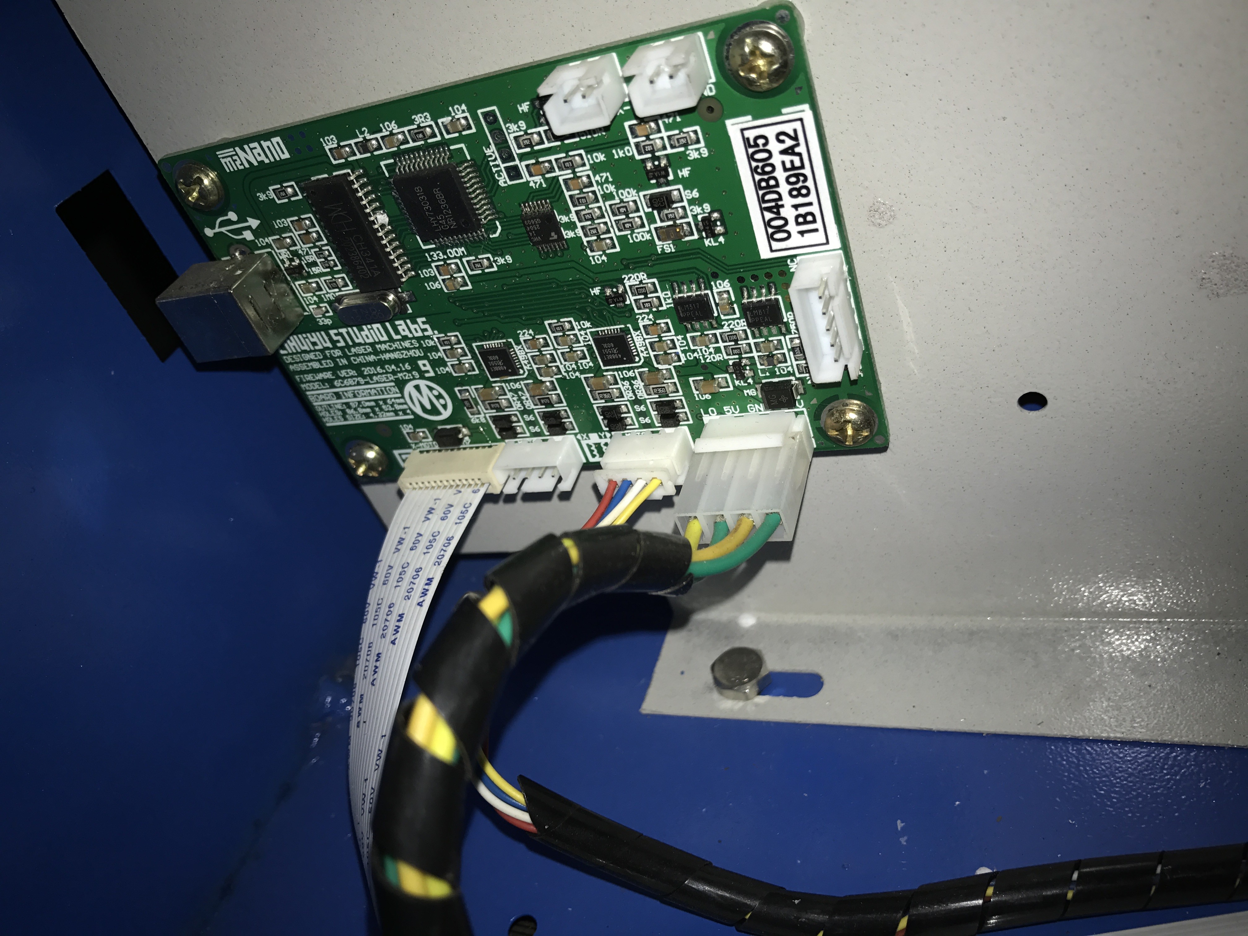

Drop here a picture of you current PSU and Stock board to take a look at the connectors
@Ariel_Yahni_UniKpty
@Charlie_Thcakeray ​ you see that ribbon? That’s carries 1 stepper and 2 endstops so that need to be spliced into separate connectors so need to get yourself a middleman board ( look here in my collection for details https://plus.google.com/collection/EndMTB) or if you have not bougth smoothie yet, the two guys above can provide you a board and connectors for that ribbon
