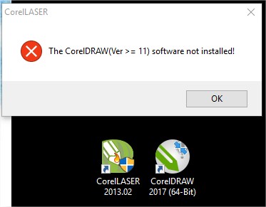

After placing the corel 2017, sometimes this error appears when I open the corel Laser. then closes and opens normally. Now do not leave here. Is there a solution to open the corel and then the pulgin?
If you installed CorelDraw after installing CorelLaser, try reinstalling CorelLaser. The error looks like it is looking for CorelDraw Ver 11.
Yeah, good Idea from halfnormal, if that do not help you could use dbugview from Microsoft Sysinternals Suite to may get some more detailed informations. But it is a mystery that this Message does not occurs in any way. So it could also a good Idea to keep this in mind while starting the app, may be you already find an work arround without new a installation.
