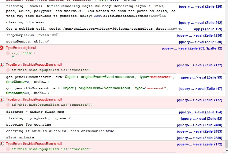

Something are complete wrong in all Workspaces. Please check this out: * load workspace, drag and drop a eagle brd file and i get a lot of Javascript errors. may somebody work on central js files? Also i get a ajax error message that some files can’t load??

Ok, here are the problem:
eagle-import: 9282:
if (this.mySceneGroup == null) {
this.mySceneGroup = new THREE.Group();
this.obj3d.add(this.mySceneGroup);
this.obj3d are not defined and calls error ‘Cannot read property ‘add’ of null’

Ok, at firefox with firebug i got a error:
“TypeError: THREE.FontUtils is undefined”
called in makeText function at Row 1564
I’m looking into it right now. It seems I don’t have my Three.js font anymore which doesn’t make sense.
Ok, fixed. Three.js released version 73 and broke a bunch of stuff. I reverted to version 72 and all is back to normal.
