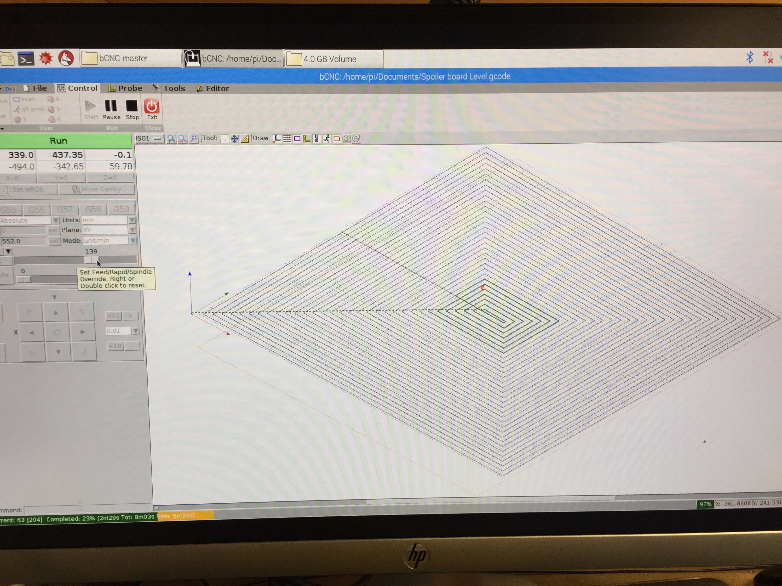

Something I’ve never done before but very interesting. The wife wants to do some wood work. I’m not a wood guy. In wood I can’t use the fancy autolevel of the new controller. So… level the playing field!
Pretty interesting exactly how far off the MDF base is, some spots off by as much as .5mm!
I had to do this for the openbuilds bottle opener it works well… Just wish I had a fly cutting bit to make faster work of it
