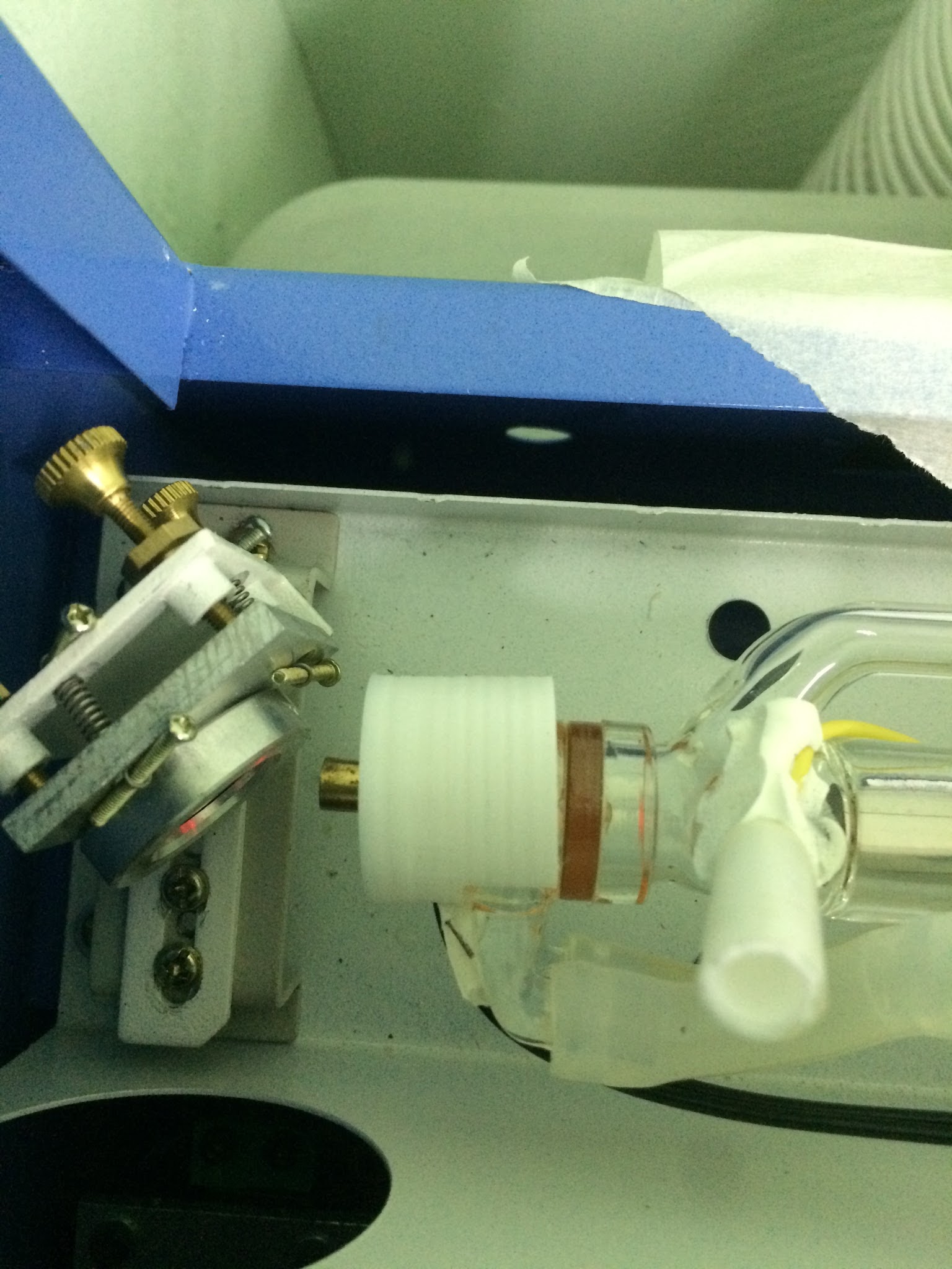

Something that I finally wanted to try to do the laser alignment, seems to be show that the principle works except my 3D printer is abit off so you need to align the red dot first. Suggest on the second mirror and the circle cut out between the first 2 mirrors, do the test dot. and you can then adjust the mirrors live. But have not fully tested the method yet. If anyone wants to try, I can post up the OpenSCAD files. Need to get back to other work, will be trying this again.
I was thinking about this same thing yesterday & was wondering regarding the thickness of the red-dot-pointer beam. Would it be beneficial to focus the beam of the red-dot-pointer into a thinner beam to aid in precision of centring the beam on each mirror?
