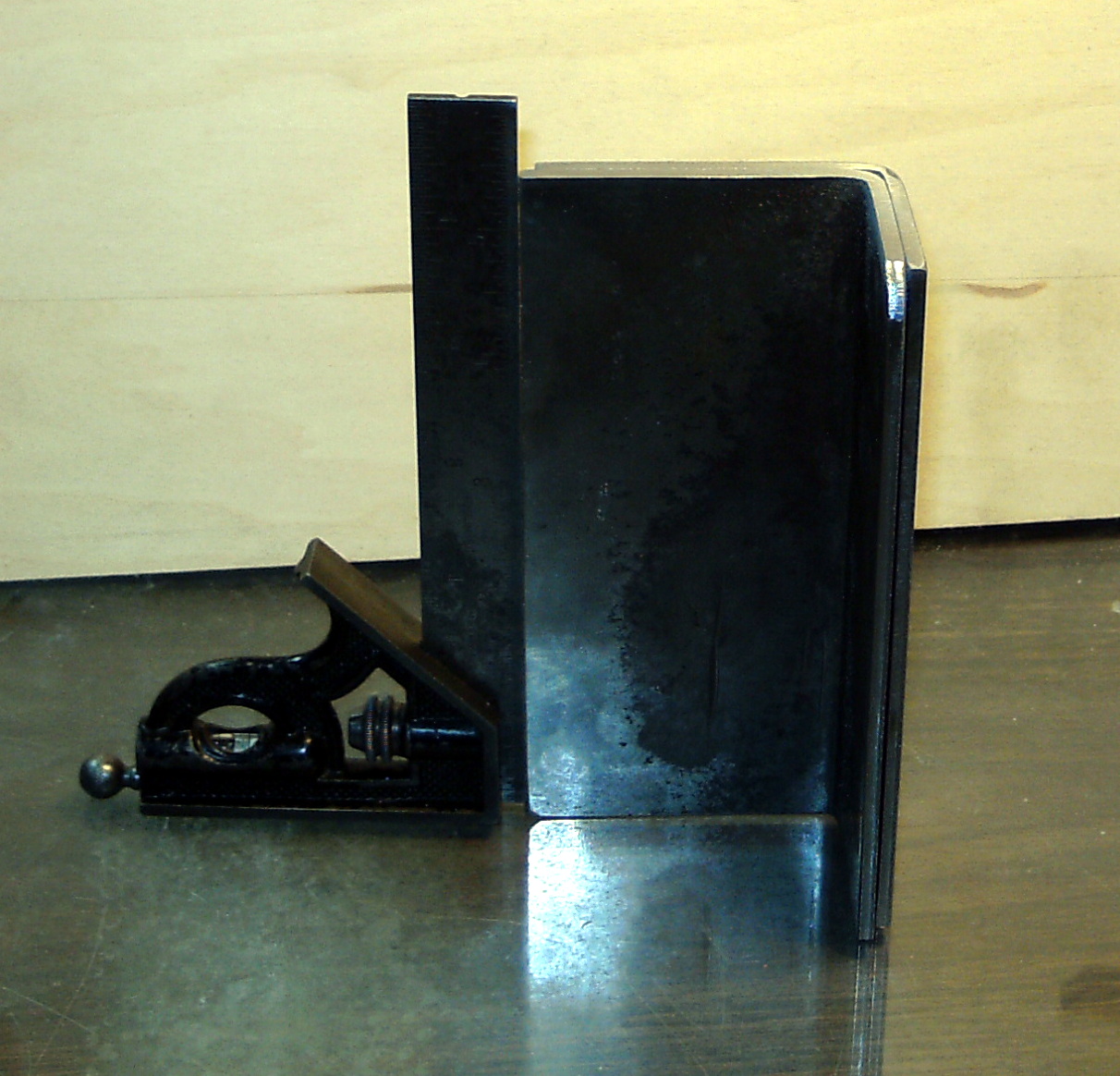

Sometimes square matters. Not in this case, but it is one gauge of accuracy.
Sometimes square matters. Not in this case, but it is one gauge of accuracy. Here identical length matters more. But things being square is nice too. I don’t have any high precision equipment so I cut stock as close as I can, then I file, and sand it to fit. It is a tedious, and time consuming process. But that’s what it takes.

I don’t have a surface plate. I use either my table saw top, my anvil, or the glass top of my desk. It depends where I’m at. For the kind of work that I do any of that is flat enough.
For any garage engineering I am of the mind that you cannot rely too heavily on accuracy. So I try to design with some built in fudge factor. I can try to get things close, but realistically I can only count on getting things so close.
The holes I drilled for these plates are about five thousandths of an inch within each other. For some odd reason one is way out. Maybe there was a chip in the fixture that I didn’t catch? That’s the way the cookie crumbles.
It still works, because it is all close enough.
