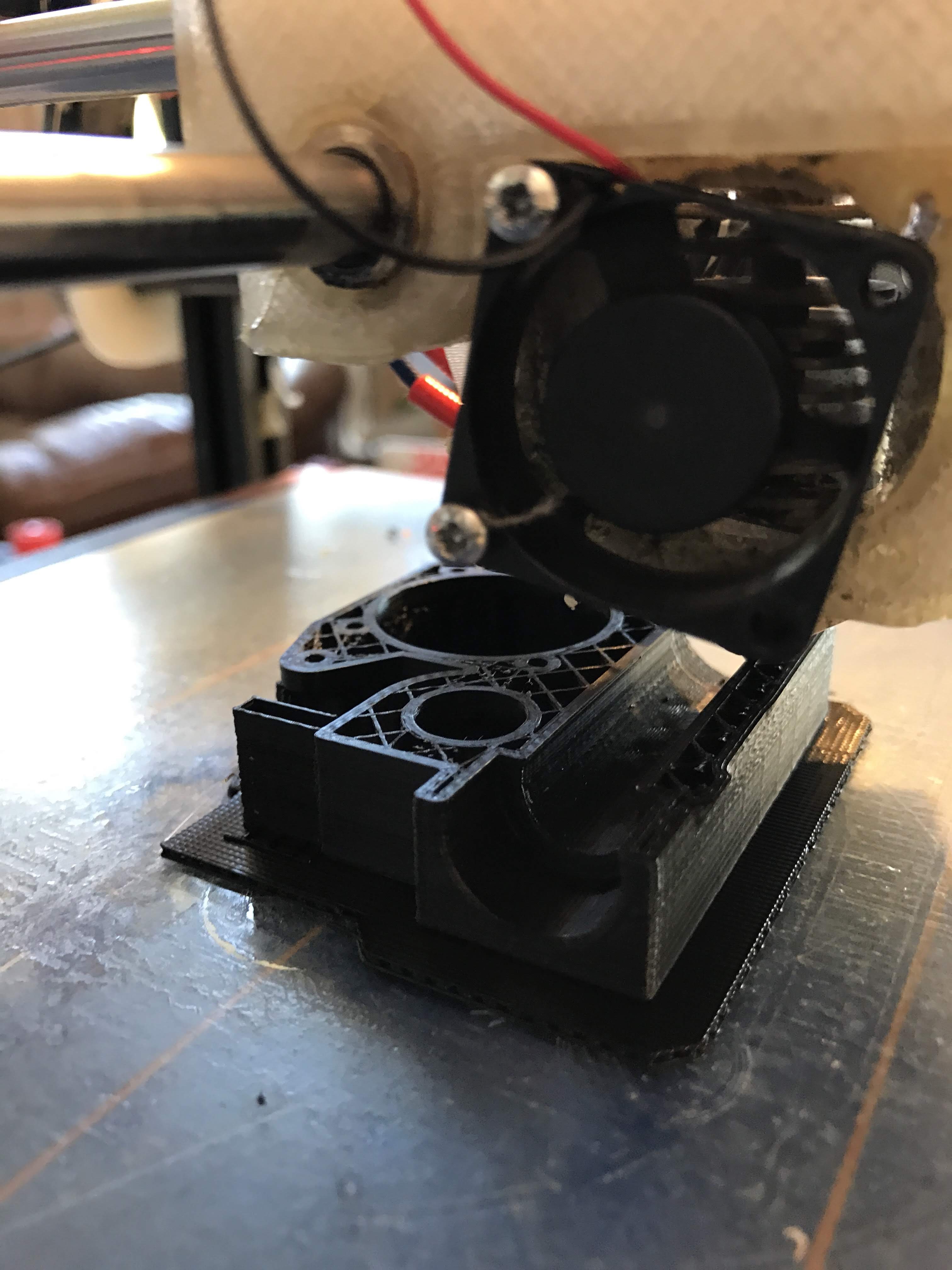

Sometimes you just have to slow down. We spend so much time going for speed and volume. I noticed the Ultimaker 3s were printing at 40 mm/s, so I figured I’d try it. Three shells, 0.1mm layer height.
And you can see by the cooling fan orientation, why a guy might be printing a replacement carriage. :slight_smile:
ehhhhhh, I’m usually printing my fastest parts at 60-80mm/s and really I’m not pushing the machine very hard. The problem is that you printed with PLA. Which we advise people against…over and over and over and over in this community, but nobody seems to listen.
Me too, and at 0.2 mm layer heights, but this speed and layer height seems to be better for ringing and overhangs.

Addressing @ThantiK 's PLA comment, the issues I’m reprinting for have surprisingly not been thermal. The ‘potentially hot’ side of the carriage, while showing some discoloration, hasn’t changed geometry.
And I’m kinda in a bind as the only printer I have working doesn’t have a heated bed, and the printer with a heated bed needs a carriage, so you do what you need to do.
Well, if the PLA carriage doesn’t work out, someone around here can surely send you one in ABS.
Once the bushings arrive in the mail, I’ll be able to print ABS…PLA carriages work fine for an extended period of time (this one’s been in service for more than a year.)
