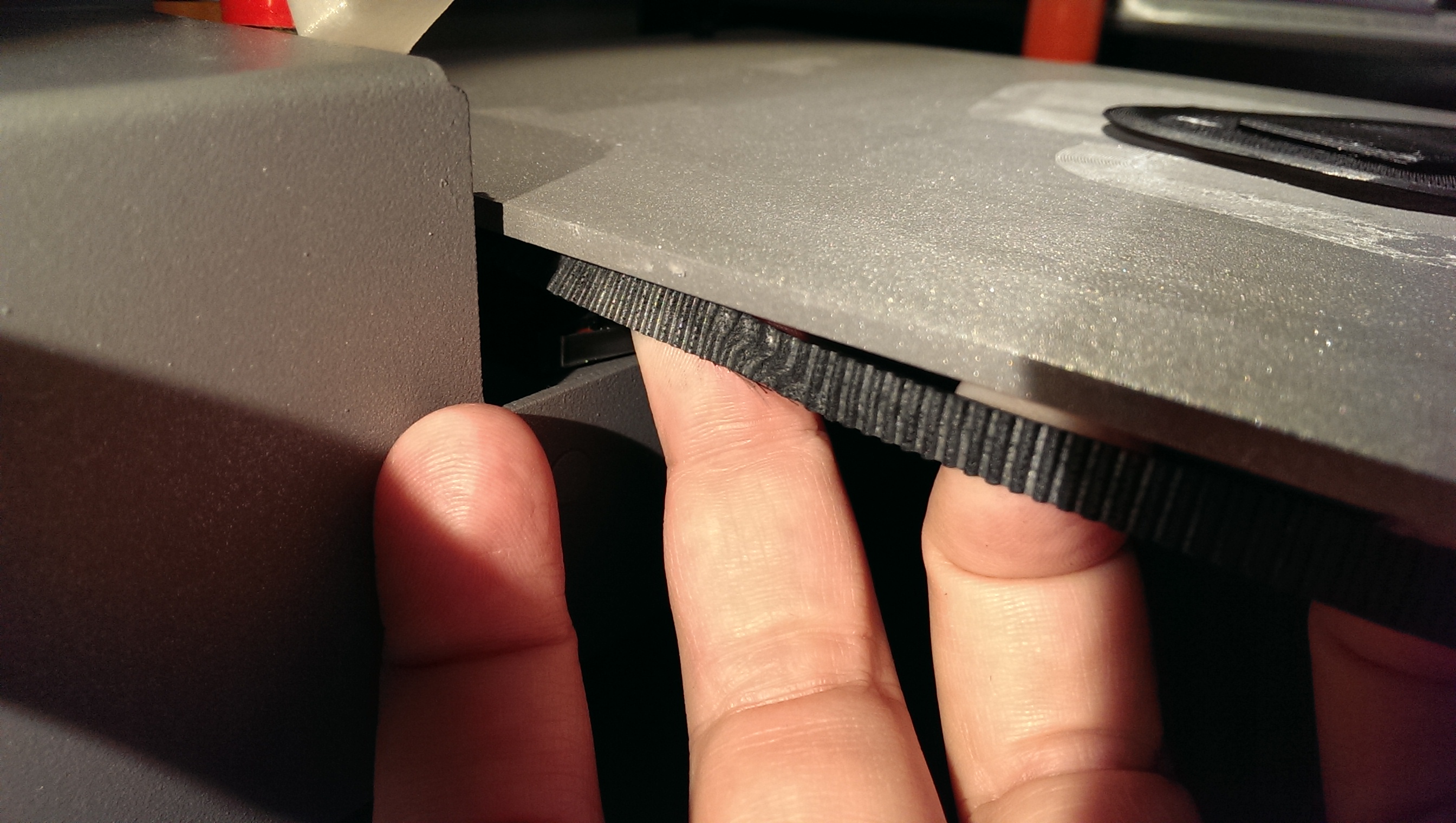

Soooo... Looks like my printrbot has a bad belt.
Soooo… Looks like my printrbot has a bad belt. I hope it is pretty simple to replace. Should I stock up while I’m at it? Is this part of regular maintenance or an unusual event?
Weirdly, the actual consequences of this appear to be underextrusion for only certain parts of the model (i.e. when it’s passing though this part of the X axis). It doesn’t actually skip at this point.

It doesn’t hurt to buy more, but I’ve never had a belt go bad even with a chunk of pulley missing. So I don’t know what happened there.
Could be manufacturing defect as well.
Taking a close look at the belt, could it have gotten stuck and been ground against by a metal pulley?
First one I’ve seen do that. I’ve had them break after ridiculous over tightening though.
The printer hasn’t gotten stuck on one spot in the X axis during any prints. I have had some trouble with tension on that axis though; my first couple prints had some layer shifting, and I noticed that the X axis belt was much more slack than the Y. I tightened it a bit, which sorted out my printing problems, but the X belt was never as stiff as the Y.
I guess it was probably a defect in the belt, and it was gradually stretching and grinding in that spot. It just now got bad enough to degrade prints.
On closer look, that looks like it might be a splice in manufacturing that is rupturing. There is a diagonal pattern going on there.
