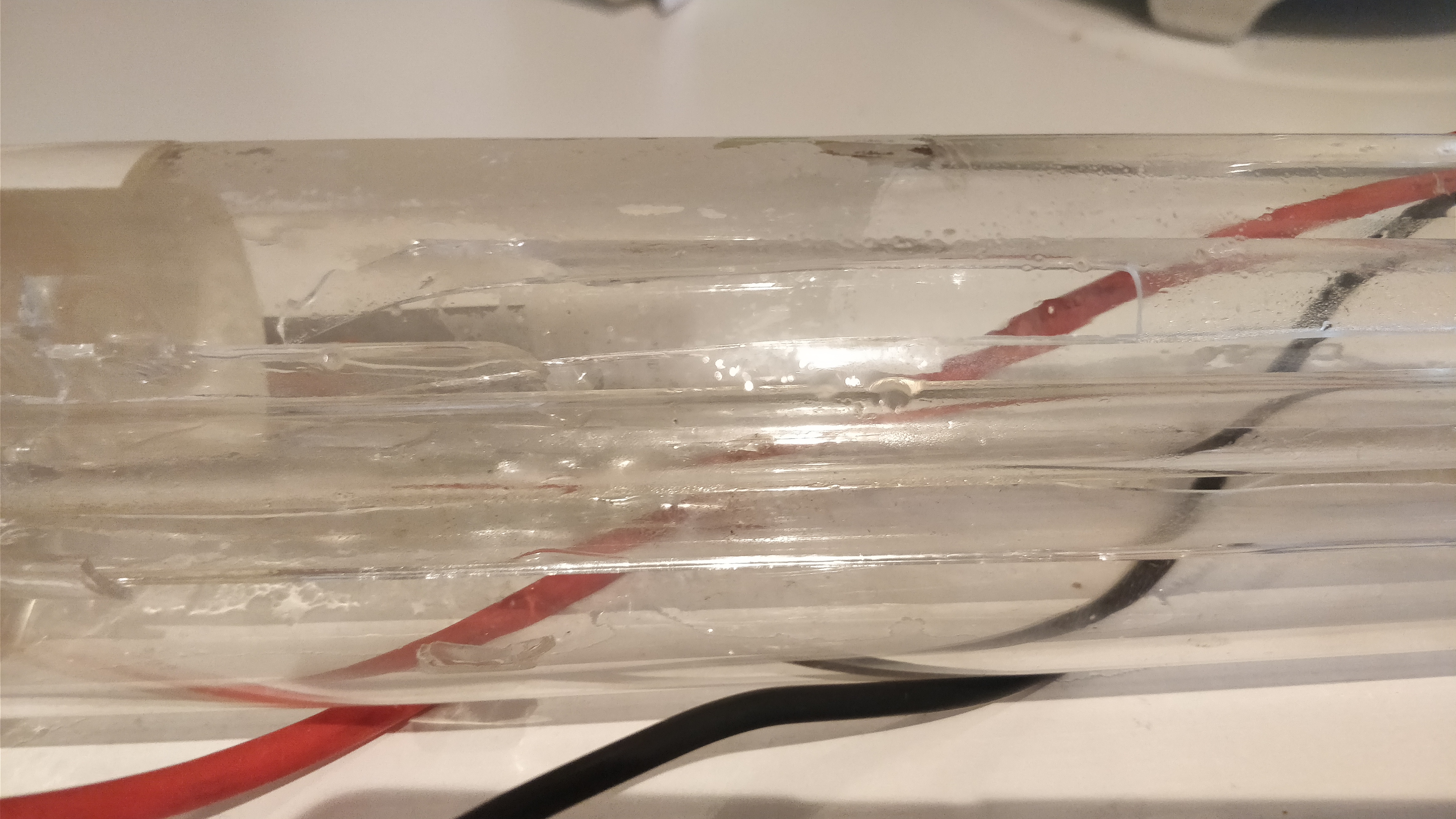

Soooo my laser tube broke because i forgot to drain the water.
Anyway when looking at my tube I found that it’s actually 800mm and not 1000. I thought i bought a 50w laser…

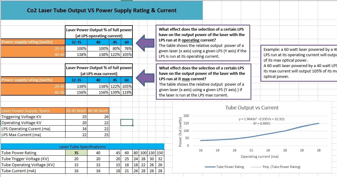

So the question now is should I go for a 800 or 1000 replacement tube?
How will it effect my PSU?
