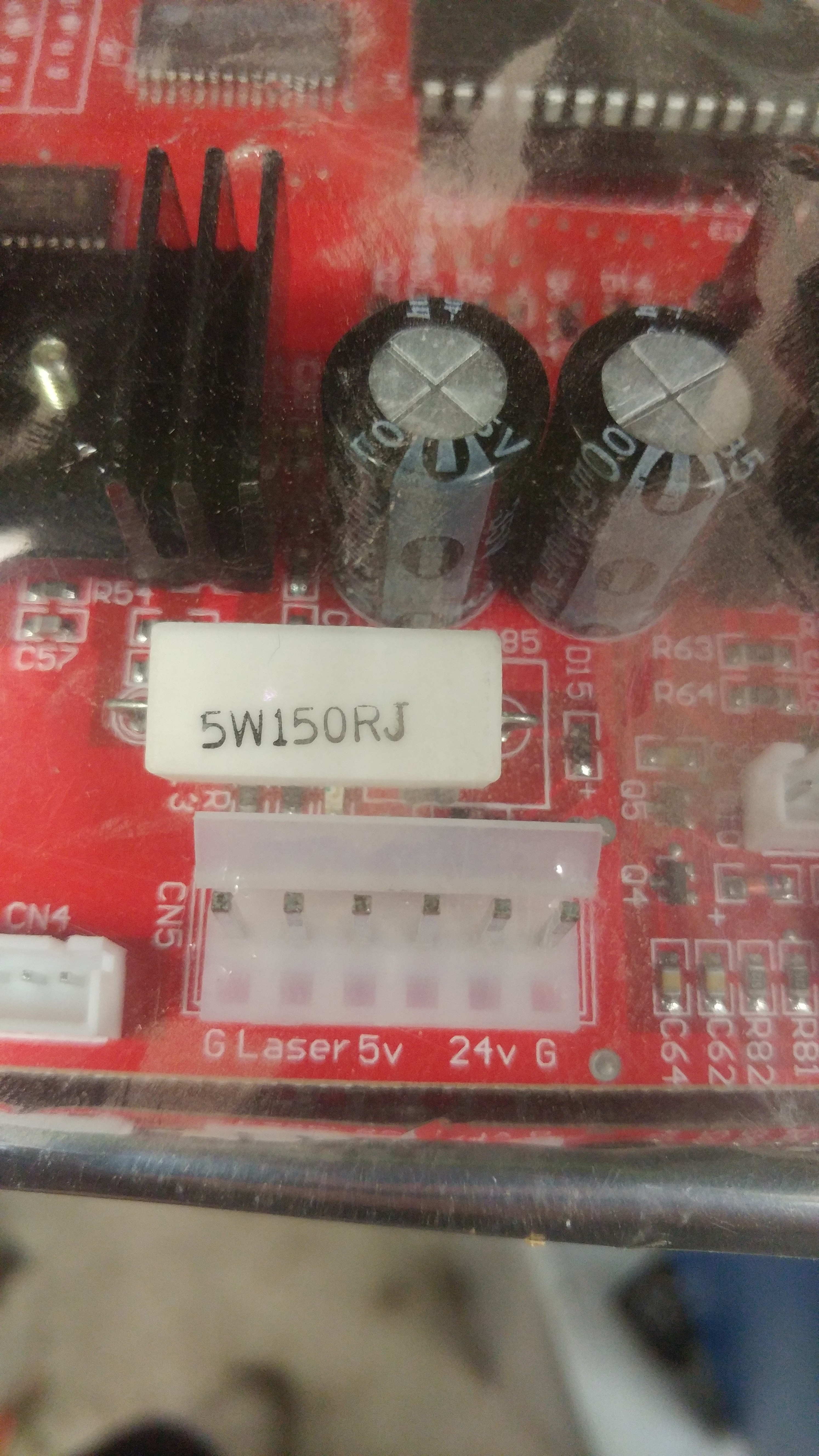

This is a less common board, we’ll have to finagle some items around. Start with the ribbon cable. See if you can identify the motors, endstops, and individual items in the power connector (that’s the big one, probably 6 pins)
There are a few instances earlier, search the Cohesion3D group for moshi, moshiboard, etc… or just scroll most of the way to the bottom. https://plus.google.com/u/0/117786858532335568822/posts/TfiJPuYAdAn
Power is at least identified for the most part. 5v on the left. 24v on the right.
It would appear that the ribbon controls the X axis (L/R) while the Y axis has a stepper motor plugged straight to the board (CN4).

For the power cable, there are 2 options. Rekey the pins in here to keep the 6 pin housing.
Or cut the board end off. 24v, gnd, and L all have screw terminals for you to put the wires in. L goes to 2.5 - bed which is the 4th from the left bottom screw terminal.
The 24v and gnd are top left.
Get acquainted with the pinout diagram for Mini on the docs site.

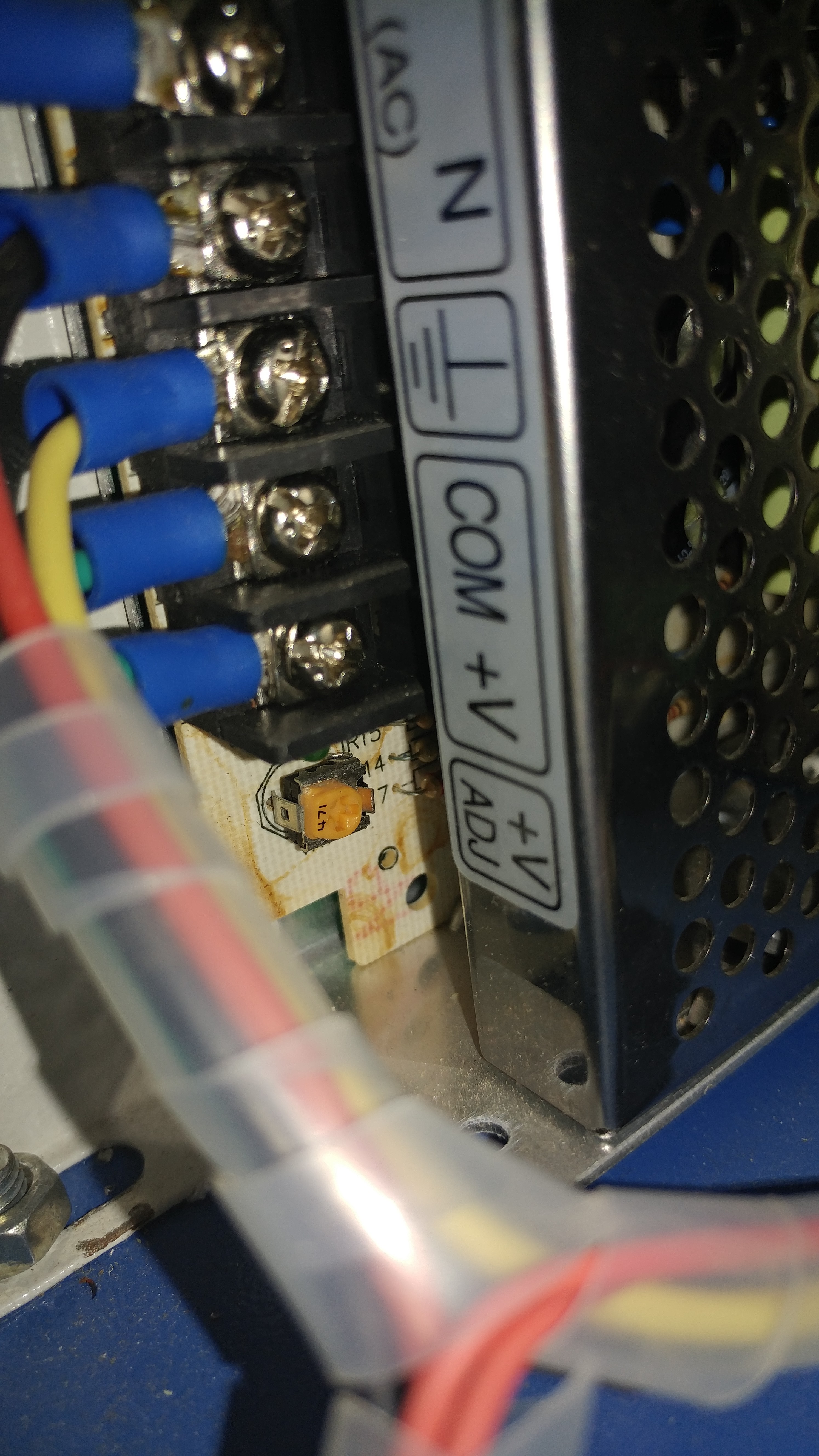

Yes ribbon is fit both endstops and x axis and y has the plug to go straight to the board. You’ll need to swap +24v and G around if i remember correctly as they are reversed on the C3D board. Also you will need to cut that plug down by one pin to allow it to fit the power pins on the C3D.

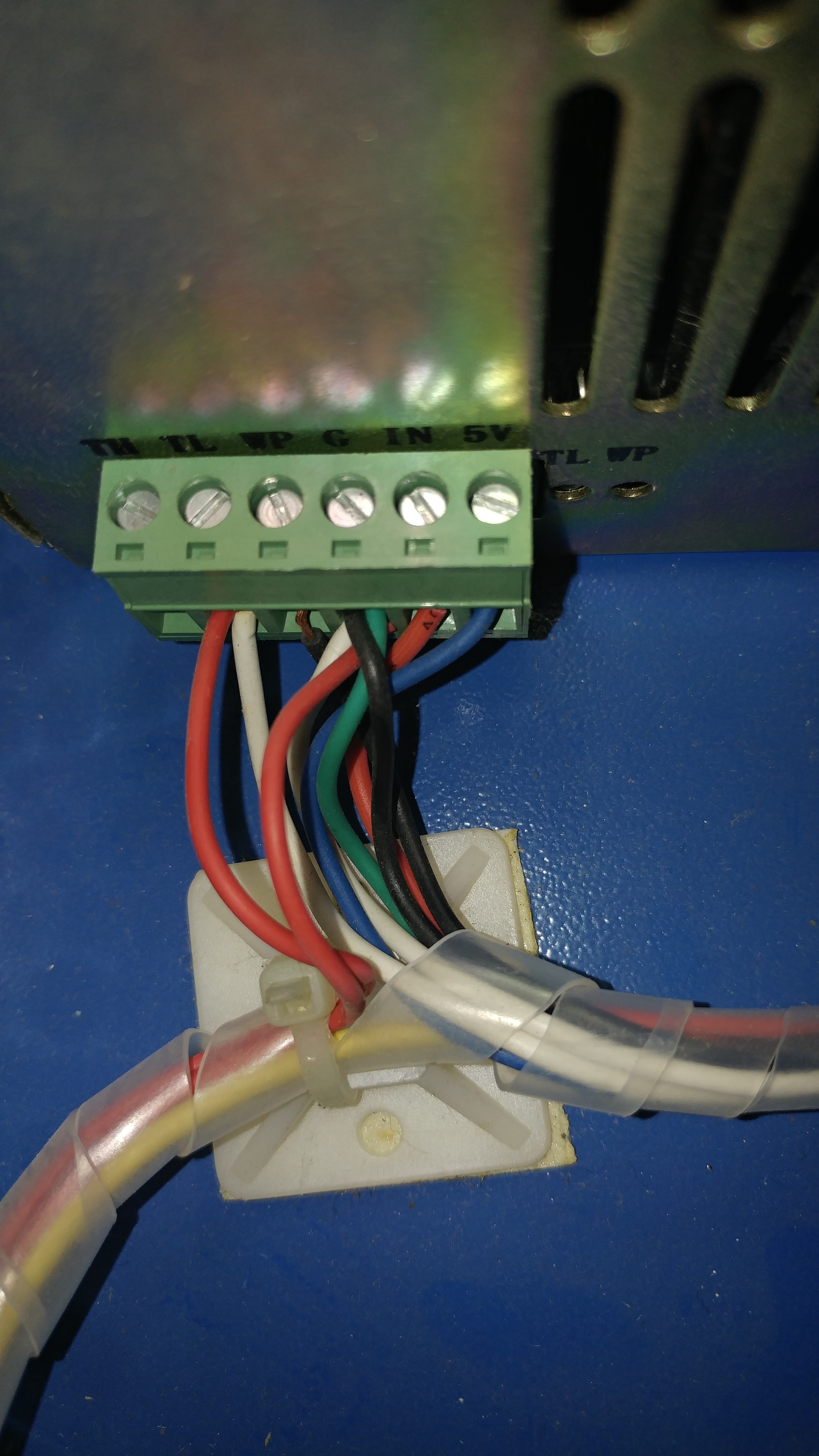

Can u show a pic. of the PSU connected to the Moshi board? would help with figuring out what goes where, there is a bunch of them for moshi´s.
These are the 2 red wires going to Moshi. The 2 pulled to the left and up. According to Moshi I need to swap them in the power connector as the C3D is Laser, Open, Ground, 24v… The Moshi is G,L,O,O,24V,G.
I’ve reconfigured the connection accordingly. The board powers up but does not home the laser.
