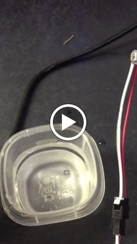

Soooooooo maybe I don’t need to worry so much about the rain getting on bare WS2811’s?? Lol I have 300 I want to put outside and half are wrapped in heat shrink and silicone. The others are bare. I’ll see what happens. Lol

Be careful man. use clear packing tape in a pinch but I would suggests not going without some kind of insulation. Ws28xx can require a lot of amps to run depending on the led count.

i think its not so much the rain nut the corrosion which will occur i would suggest glued heat shrink quick to use and seals its self when shrunk just my opinion
Now that I think about it maybe a quick dab of hot glue on each bulb and the contacts on the back?
I would do test Frist I used hot glue on some smd leds and it melted them.and they stopped working so try it first
Yes it works a while under water / in rain. But keep in mind, that even with distilled water a current between the cables is flowing which means that an electrolysis will happen. And that means your metall will corrode until it dissolves completely.
Hot glue is better than nothing. Transparent 2K Epoxy is the weapon of choice for ever lasting underwater installations.
