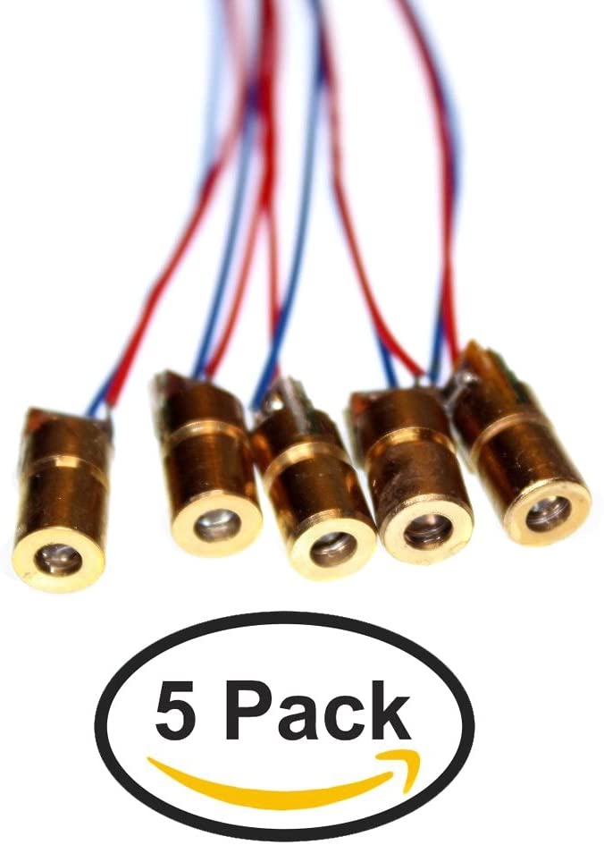

I used one from amazon that runs on 5V. I wired mine to the 5V supply and I leave it on all the time. Alternately, you can wire a switch in series with the 5V and the anode of the diode, putting it on the panel or wherever convenient!

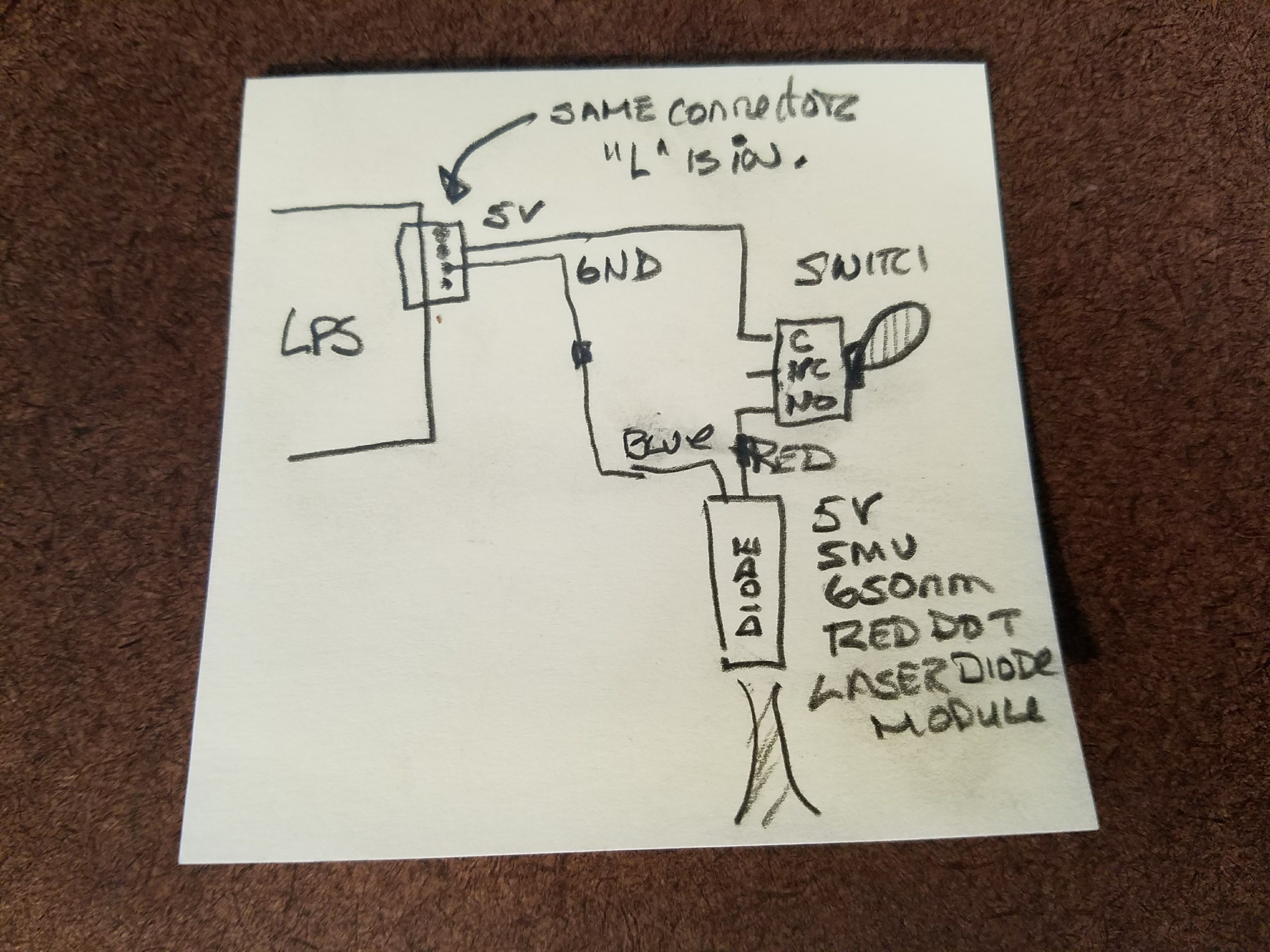

@donkjr Do you have a write up or can you show me how you wired it to the 5V supply. I’m assuming you mean you wired it somehow to the power supply of the machine?

On mine, the power supply had a 5V connection marked and a ground, so I tied it in there: https://www.thingiverse.com/thing:1002341

Here is how mine is hooked up. Mine does not have the switch …
Does that help?

@donkjr Yes sir, thanks alot!
