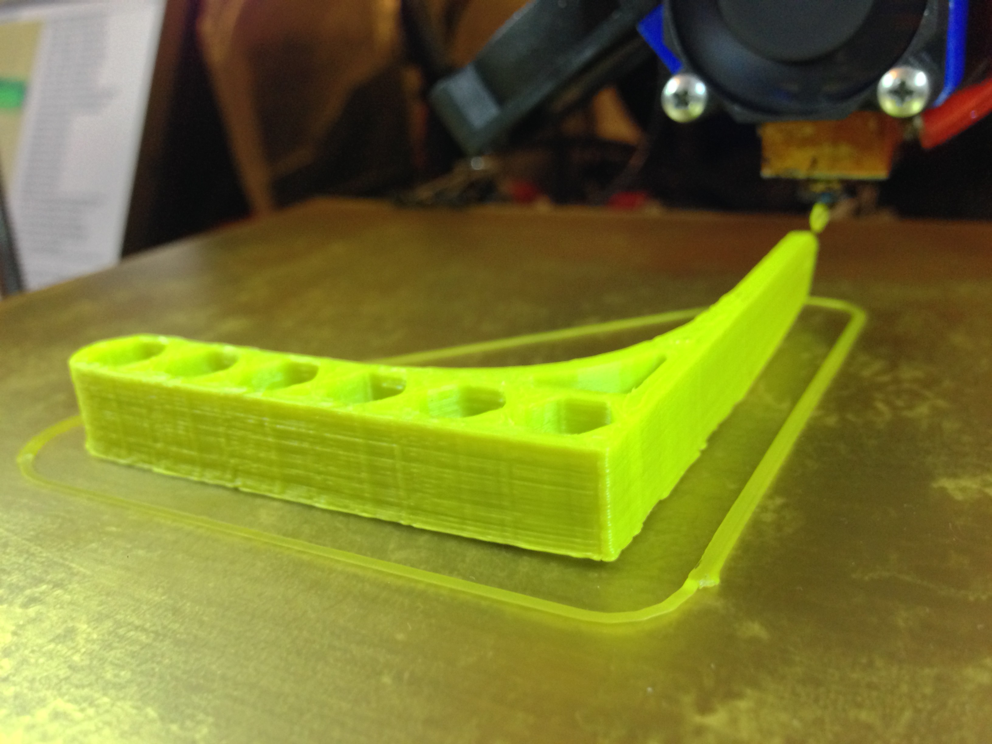

Sourced a PEI sheet for my bed,
Sourced a PEI sheet for my bed, printing Lulzbot ABS @ 245C onto the bed @ 85C with no brim, 100C with no brim and then 85C with a brim.
It’s very good, I think this will let me lower my ABS print temps. Parts just snap off when the bed is cool. Next up try PLA.
Only the first peeled up at all.
Also I need to change my starting and ending G-code, if you plug the nozzle on the bed while heating up it will melt a little spot on PEI, which melts at about 190C.
