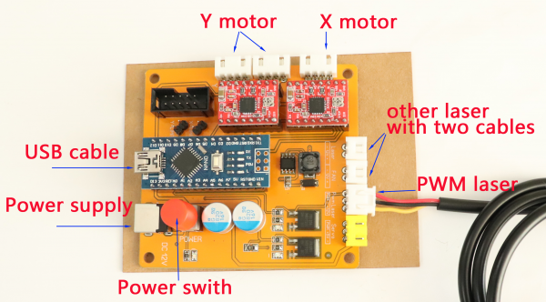

Which control board have you?
Is the setting in le correct? Correct board selected, grbl, smoothie, Marlin, …

I have a Bachin Laser 4050 with, I attach the board picture.
Default GRBL version was a custom one, I updated to the last released (1.1f) and I solved a lot of problems doing it.
