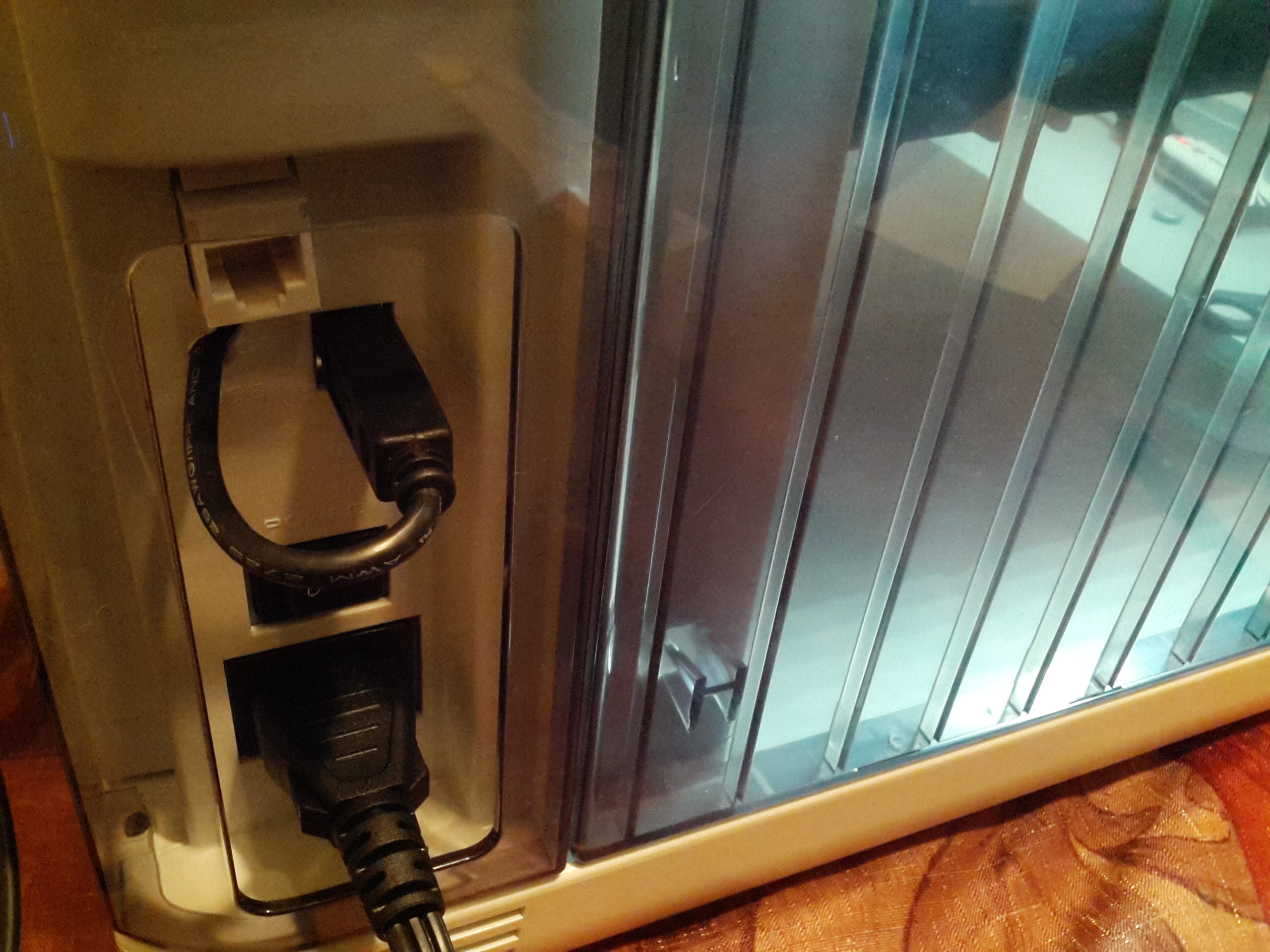

Spent some time making some fun upgrades to my Da Vinci 1.0.
Spent some time making some fun upgrades to my Da Vinci 1.0. It now does dual band WiFi, has an available Ethernet port, and HD camera with a integrated raspberry pi running octopi!
The printer powers the pi, and I was able to get everything nearly installed with some decent attempt at cable management!

Ah, cake… Cable too. I can’t stand auto correct. The stickers were to help me better understand the calibration numbers on the bed leveling test. I have since learned to use just a sheet of paper to level manually. Much faster and far less frustrating than waiting for the davinci to figure out its z probe. Pretty sure it isn’t that accurate to begin with.
