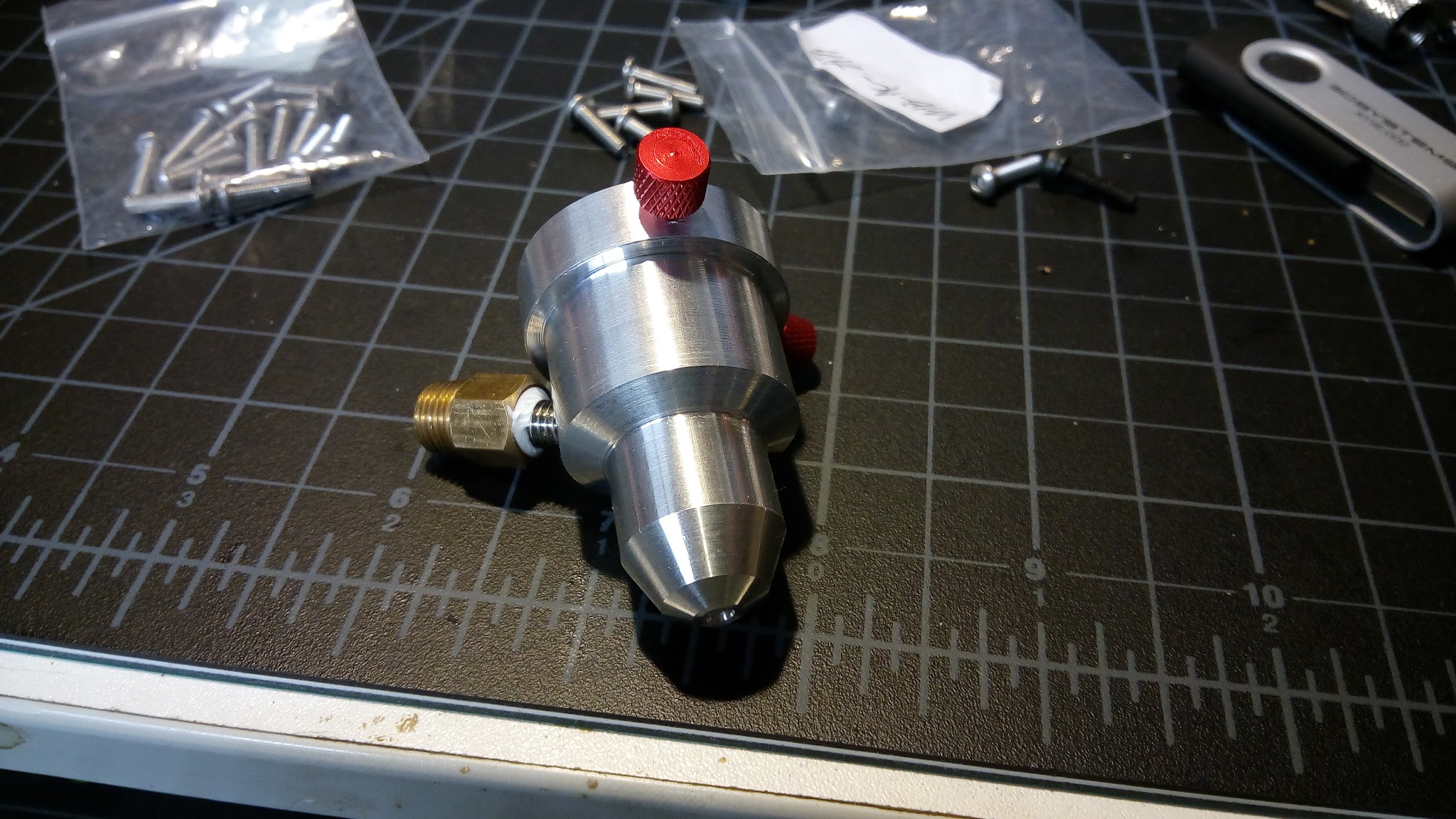

Spent the past few hours machining an air nozzle for the machine while I work on a completely new head design.

Did you use your tailstock with a drill bit chucked up to do your air cavity?

Thanks for the welcome! Yes. I drilled it initially, then I bored it with a boring bar.

How is the weight compared to stock or a brought ons as you do not want to add to much mass and overload stepper moters
I tried to keep the weight down. Its not too bad. I wouldnt be worried about overloading the steppers as much as affecting acceleration rates, and possibly inducing some jerkyness on fast direction changes as higher speeds.
it looks good what id it made of
Aluminum , and a stainless steel and brass hose connectiont
