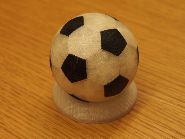

A soccer ball design that can be easily dimensioned to a 20 cm diameter. composed of 20 hexagons and 12 pentagons. I also would need to modify it to add various mounting tabs to screw the 32 separate pieces together inside the sphere. But that would either require me to spend $$ on my own 3d printer or get it built at a 3d printing shop. I checked a couple 3d printing shops and that would cost me around $200 to build !!!
For $200…
Mind you that’s US, so for a Canuck like me that would be closer to $270… plus whatever the government dings me with when it comes across. I’m still VERY tempted though. :slight_smile:
I’m a BIG fan of prototyping and building with cereal box cardboard. If you laminate 2 or 3 layers, it becomes very rigid. With hexagons and pentagons, should be do-able.
