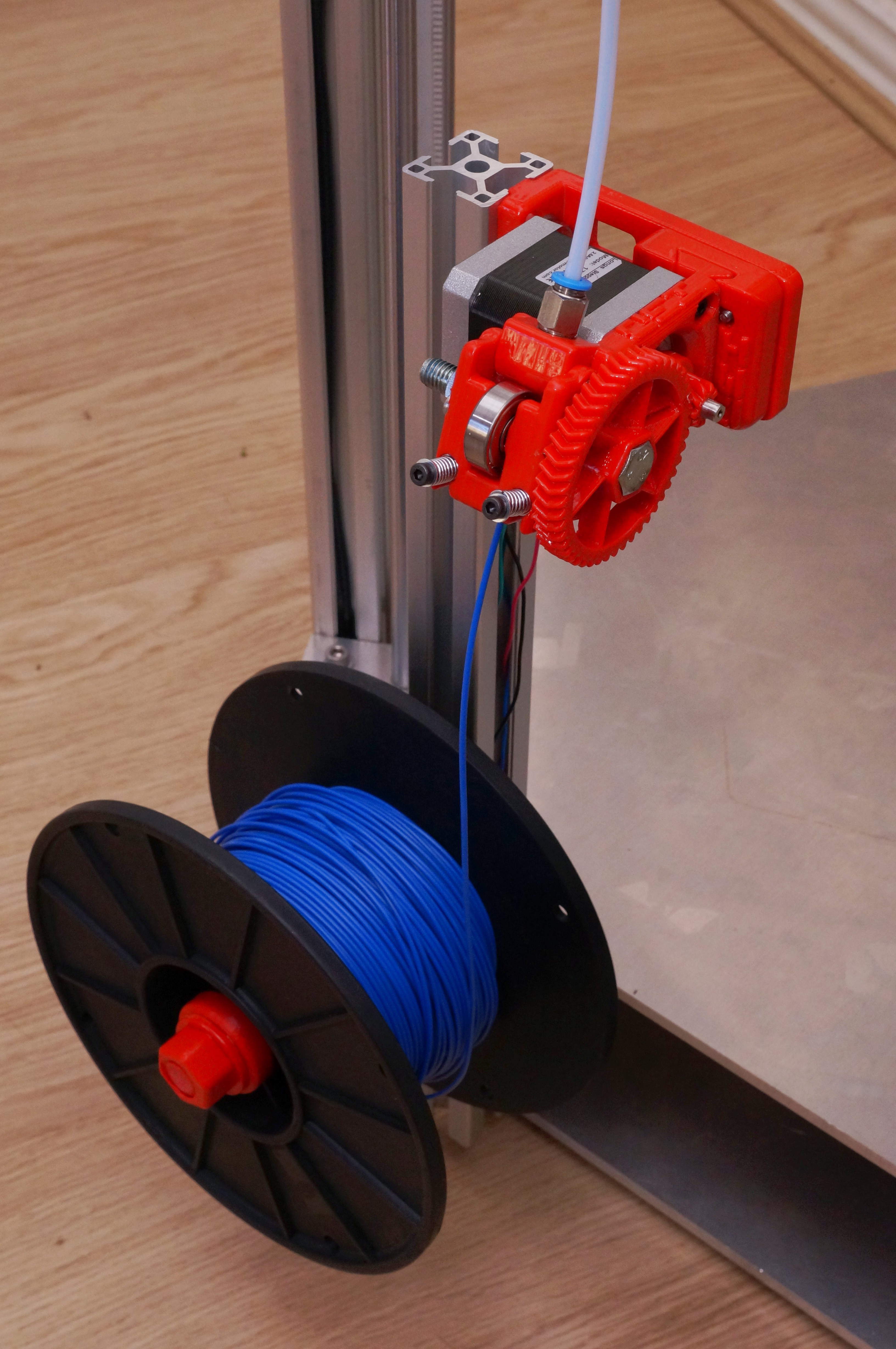

Spool holder and vapor smoothed extruder made and tested so one step closer to printing
Spool holder and vapor smoothed extruder made and tested so one step closer to printing on my custom delta machine. #Smoothieboad made tuning childs play.
I’ve been following your delta build and look forward to seeing prints.
Shouldn’t be far away. Hot end was finished yesterday and is ready to wired in the Smoothieboard and tuned. Then just to cut the alloy plate for heated bed, and fit the heater once I find a supplier that doesn’t charge a fortune to ship to Australia. Getting excited though.
I would love to try out that extruder, I think it will fix the problems I am having. Could you share the model?
To save time and re-invneting the wheel I used the extruder from Infill 3D which can be found here http://www.thingiverse.com/thing:566791
Perfect, thanks!
