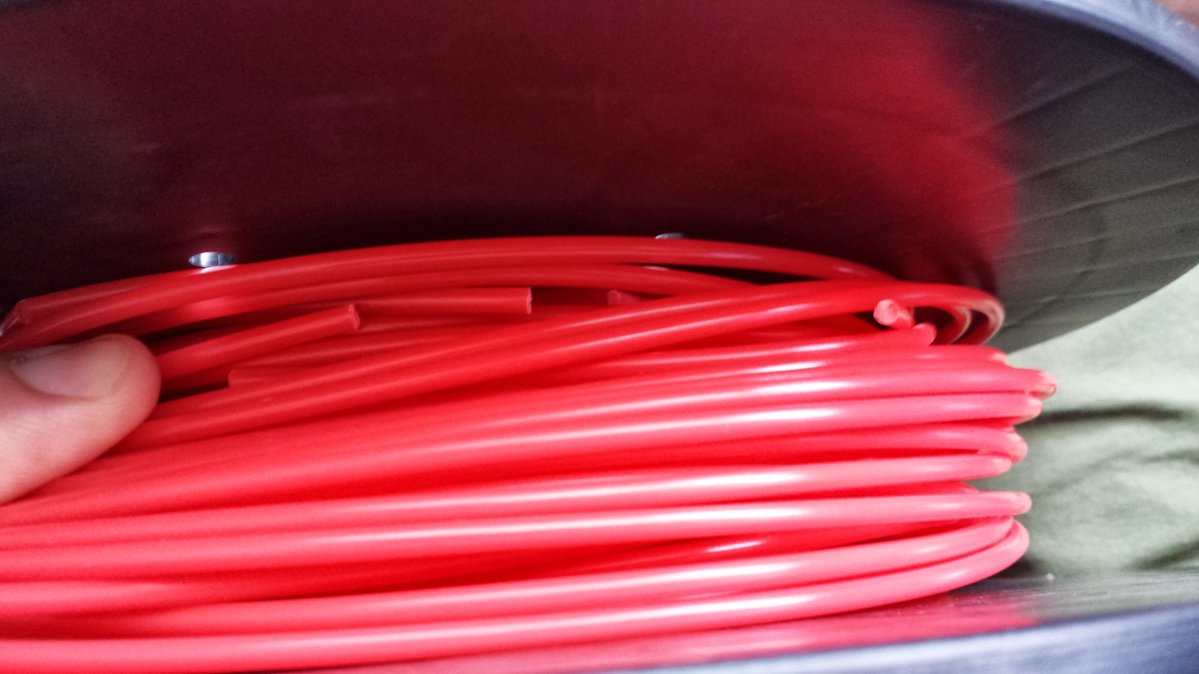

Spool of surprises. During a printing parts of filament dropped on hotbed,
Spool of surprises.
During a printing parts of filament dropped on hotbed, when I looked into spool I saw this.
I try to get replacement from vendor.
1 out of 3 ordered spools had this, anyone had similar bad spools?
Maybe it is because of bad environment in warehouse (too cold)?
what dropped was chunk of the filament - as you see on picture there were many cut(broken) pieces. and about 10cm long filament dropped on bed while printing.
the spool never dropped (unless it was in transport, but I don’t expect to break like that on spool drop)
I bought it at makerfarm. They respond fast to my email and they will give me discount on next purchase of filament.
If the filament is extruded improperly (when it was first made), it can crystalize and become brittle instead of forming a proper copolymer. Kinda like you can harden many steels by heating and rapidly cooling them.

Chunks of 10-20cm long aren’t by purpose.
I try to extract longer parts when I have a time, rest will be dumped to PLA recycle box.

@Thomas_Sanladerer While PLA can crystallize and become less ductile, copolymer is not the proper term. You mean amorphous. Some plastics are semi-crystalline and some are completely amorphous such as ABS (which is actually a block copolymer). There are no plastics that are entirely crystalline. PLA is a semi-crystalline material. The degree of crystallinity in a semi-crystalline material is dependent on a few things, namely the rate of cooling when it is extruded, molded, etc.
Unless they didn’t use a water bath and cooled it very slowly it’s unlikely that over crystallization is the problem here. It’s more likely that the molecular weight of the raw material was too low, excessive colorants/additives were used, it was degraded while in the extruder barrel, or was exposed to low temperatures while stored.
This newsletter http://www.zeusinc.com/UserFiles/zeusinc/Documents/technical_newsletters/Zeus_Crystallinity.pdf does a pretty good job of explaining the basics of plastic microstructures and the effects they have on the material properties.

I have that fillament too. Keeps breaking during a print. It is also on a small spool so it’s very tight wounded.
I would like to add a tube to let the extruder motor off the x cariage, but with this fillament i can’t push it through a straight tube… : (
