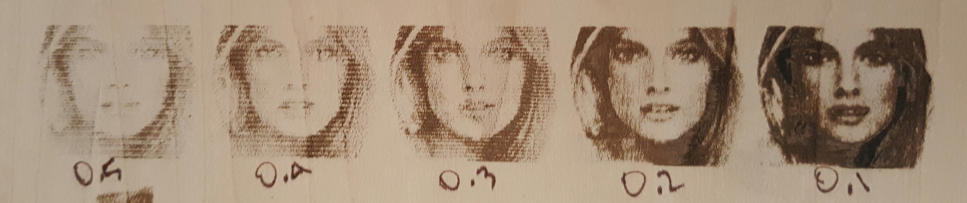

Spot size compare. Same speed / power. Smoothieware new-laser firmware test. 3.8w Laser Diode
Try .150 looks like the sweet spot is in-between .1-.2
Nice test. I’d agree with Alex about the sweet spot, although I imagine it could vary somewhat between differing images.
+Peter van der Walt when gcode is generated in LW does spot size only effect steps on the Y axis or does it also change the steps in-between X moves and generating those steps based on your Dpi settings?
My votes for 0.2. 0.1 a little too dark what about 0.15??
