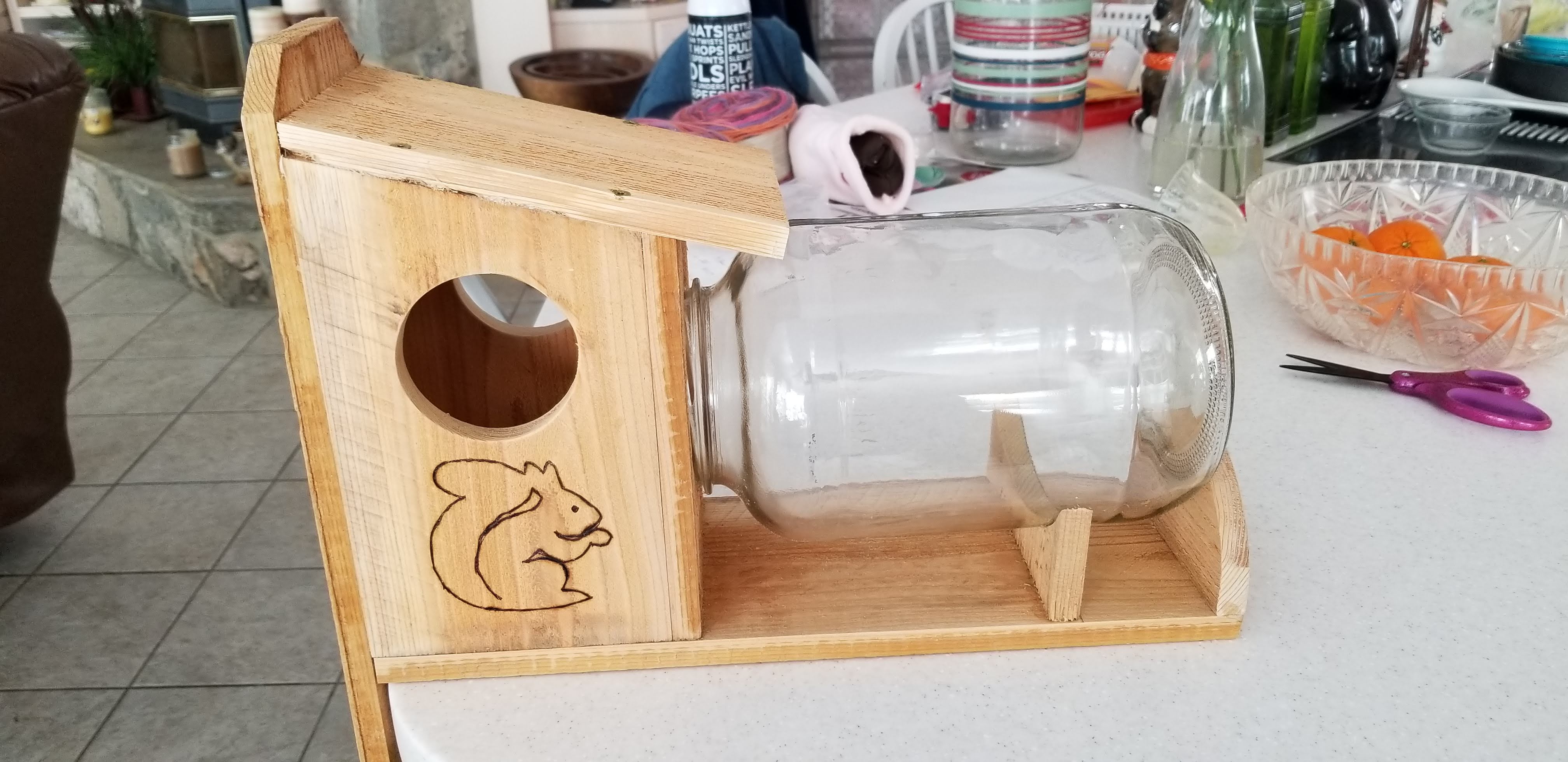

I have had enough winter for one year so I thought this might bring on the spring!
Nice, I have one of those in my yard that someone gave us years ago. It’s getting a bit ragged and needs to be replaced, so I think I might give it ago making one. :slight_smile: What did you make yours from?
5 1/2" wide 6 ft long cedar fencing slats!

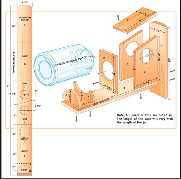

Used these plans
The tough part was finding a 1 gallon pickle jar.
Got one from Wallmart and now I have lots of pickles…

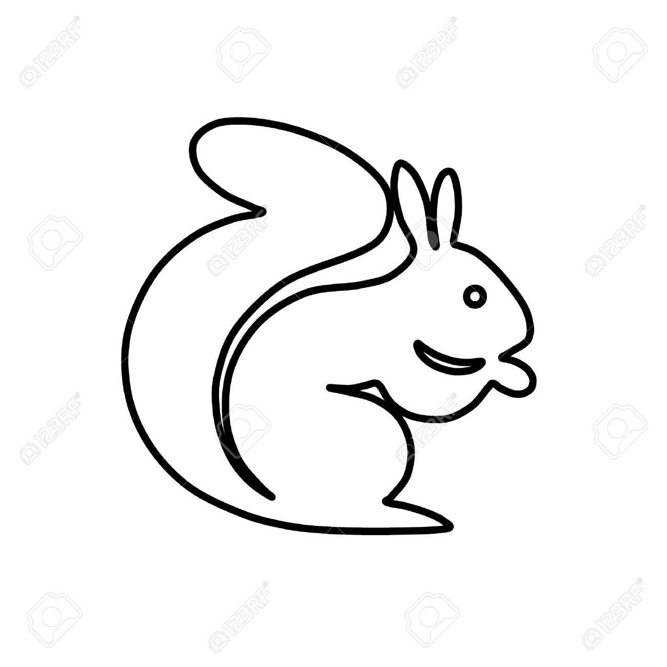

This is the graphic I used.
