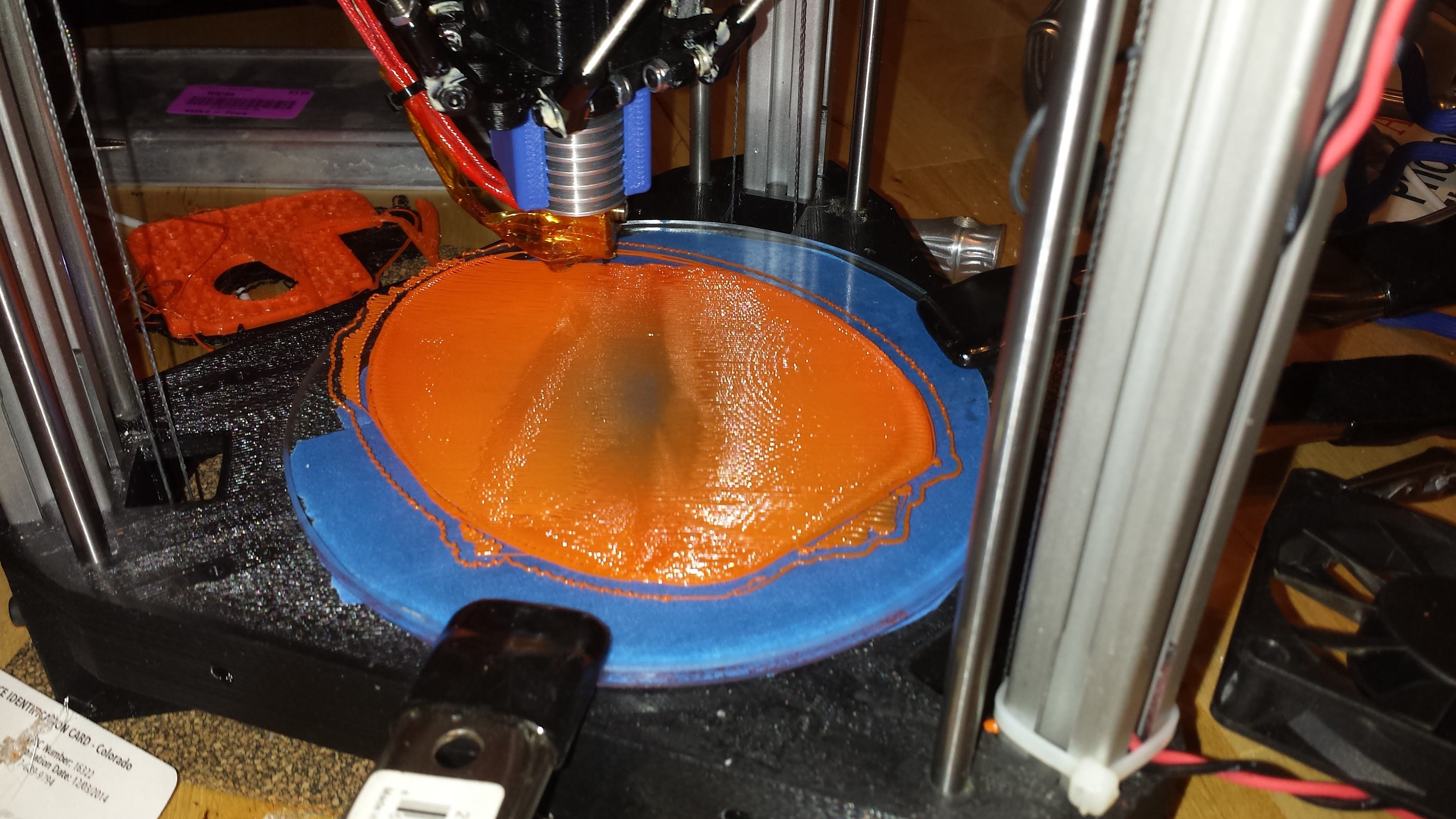

Squishmap... Doesn't this tell you I need to shorten my delta_smooth_rod_offset just a smidge?
Squishmap…
Doesn’t this tell you I need to shorten my delta_smooth_rod_offset just a smidge?
Length of the delta arms would have been my first guess. I suppose either one could cause it, but if you change the wrong one you’ll end up with a scaling issue.
oh, I already HAVE one of those! :slight_smile: It’s 7% fat in the ‘virtual X’ direction and about 9% fat in the ‘Virtual Y’ direction and about 15% skinny in the Virtual Z direction. My Weighted Companion cube has a body image problem.
its a frisbee

I think it was actually “x” in this case :slight_smile:
