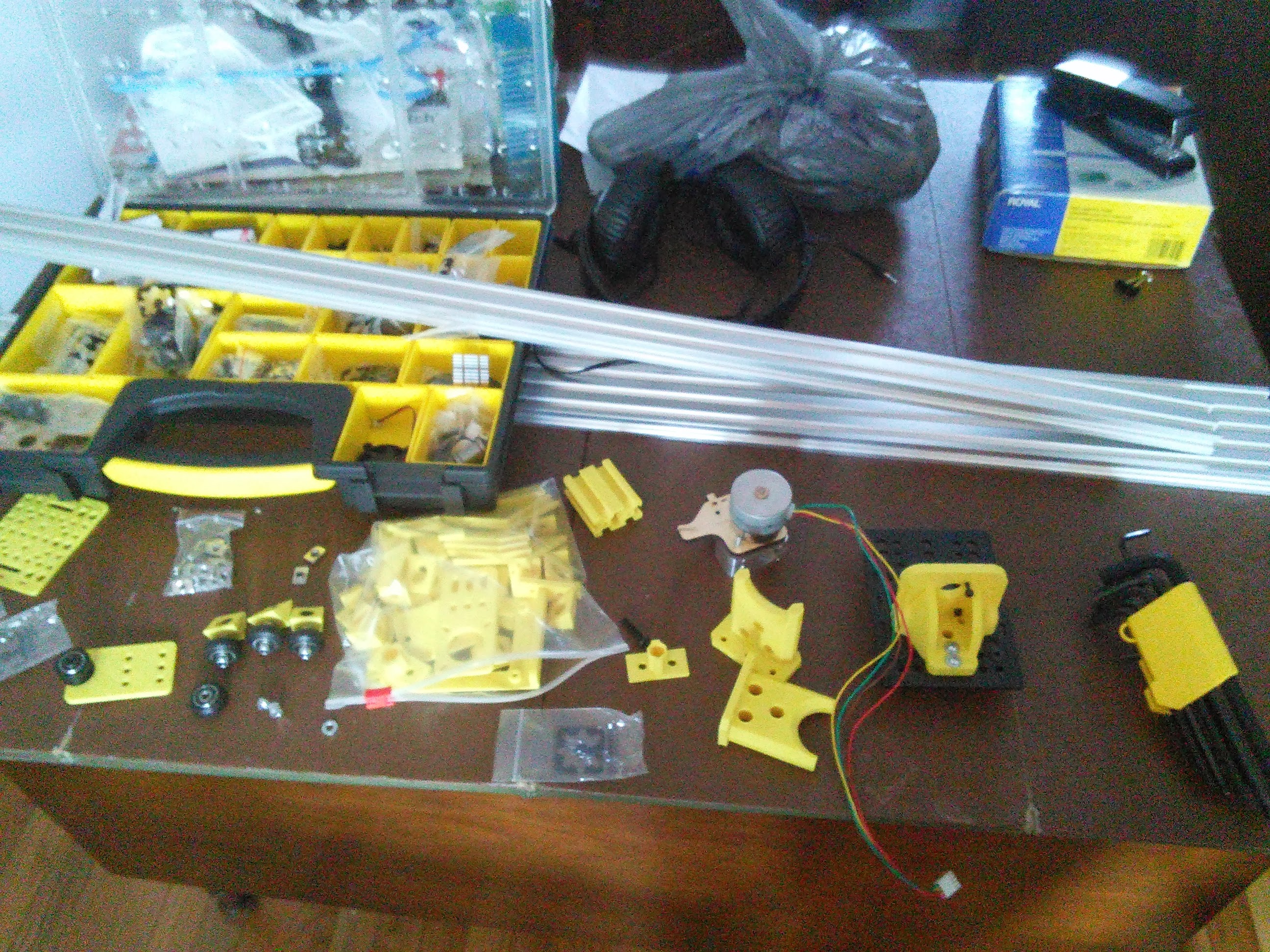

Started assembly on my printer overhaul before I go get a blade to cut
Started assembly on my printer overhaul before I go get a blade to cut this extrusion. Anyone have any particular recommendations for an aluminum cutting 10 inch blade?
