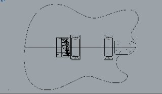

Started machining a guitar body tonight. Got a dust shoe for the machine and it’s awesome! As usual ChiliPeppr performed flawlessly. You can see the guitar top on the inside of the cavity - maple burl. (Edit - that screenshot of the CAD sure looks bad. Weird)
