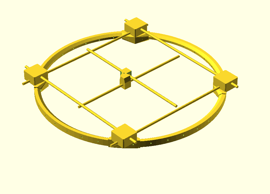

Started the gantry. how does it look so far?
I still need to do the slides and the motor mounts. I also need to add the pillars and slides.
Currently no time for mount it…but surely try before reprint for linear bearing
@Shauki
First i wanna make a try with this bushes.
http://www.ebay.de/itm/2-Stuck-Gleitlager-GLY-SKF-PBG-08-10-7-5-Bund-Lagerbuchse-8-x-10-x-7-5-mm-/400759077508?pt=Wälz_Kugel_Rollenlager&hash=item5d4f1a3a84
12x14x10 mm no reamer 12h7 available
The way the bearings are defined are [ length, outer diam, inner diam] so it should be add bushings sizes to match and it will work for both.
Ahh, let me know when you have that worked out. the work I have should be able to be recycled to make it work after test.
As i mentioned before progress on the parametric version will come in bursts. I will continue to do bushings in [length, od, id], to allow for more flexibility. When i do the tower i will do that.
