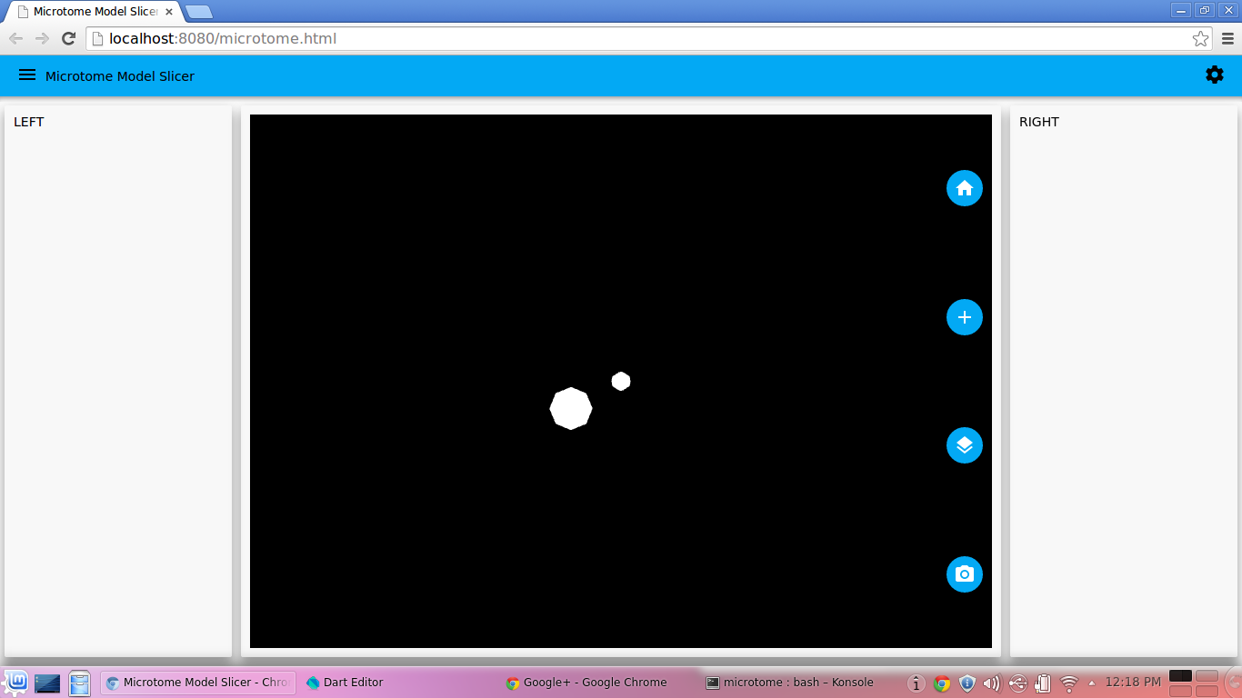

Started work on slicing / host software for DLP printer.
Started work on slicing / host software for DLP printer. Writing it as a chrome app which allows it to access serial ports, and be aware of second monitors!
Initial plan for controlling printer is using a serial GPIO board to control the driver for the z stepper. If that doesn’t work out, will switch to arduino running some simple sketches. Will not be sending GCode as its pointless for something merely stepping up/down in the z axis.
The slicing/preview software is initially purely intended for DLP based printers. So image based only. There is no polygon generation step, just using custom shaders and opengl to slice the geometry.
In the sample pic, I manually set the slice z height to just ensure the simplest things were working. If I vary it,the shapes grow/shrink as expected. It even properly handles internal voids/hollows as long as your triangle orientation is proper, and your mesh is watertight.
I’m calling it “Microtome”, which is the device used to slice thin sections of samples for microscopy analysis.
