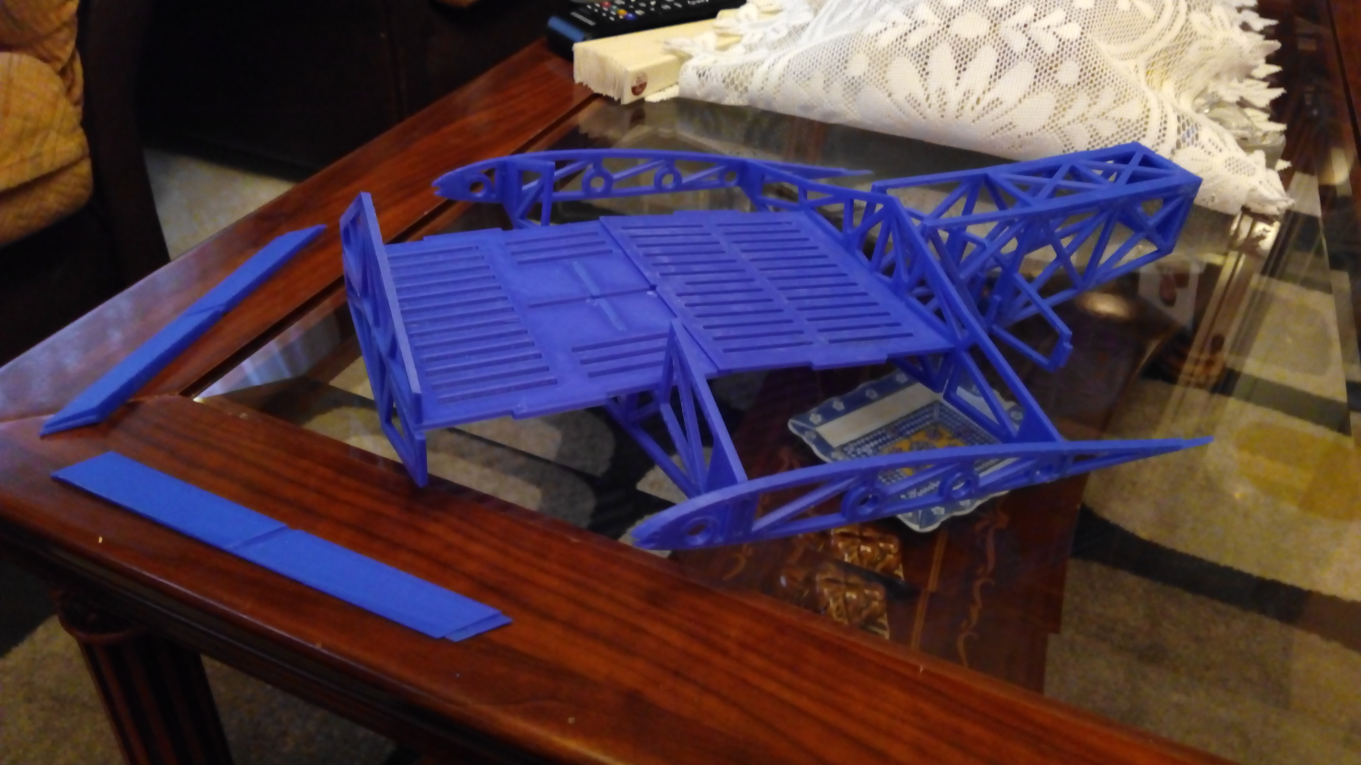

Starting to build the open swift from @Andre_Roy ​. Just starting with the canopy, and printing about one piece a day, so it’s going to take a while.
I had to split the electronics plate to be able to print it on my Prusa3 (20x20 bed), and I know I’ll need to split more pieces.
Other thing I found out is that I’ll have to design a 6 to 7 mm adapter, as I can’t find 7mm booms (only 6 or 8 mm).
I hope the people from my local flying club would teach me how to fly this :smiley:

Nice print so far. 20cmx20cm eh? And you were able print all the wing parts. :slight_smile:
I’ll check on what I can do quickly to split those parts up for that size build platform on the weekend.
Thanks for the advises about the simulator, I’ll definitely give it a go before launching my swift. Still, I’ll ask someone at my local club to put a buddy cable with me, so he can save me from troubles.
And @Andre_Roy ​, yes, with a 20x20 I can print the wings and most of the fuselage perfectly, still I had to slice the tray (as I bet you can see in the picture). If you want I’ll slice the rest of the pieces for you, I already need to do so, so it’s not a problem, I’ll share the files so you can add them to the repository (maybe you could separate them into two folders, full and 20x20 adapted).
PS: the only pieces that need slicing are the main spar, the two middle ones (the spars that are missing in the pic) and the tray, the rest is OK for 20x20 beds.
20cmx20cm is pretty small for doing this kind of printing. I wouldn’t want to support any smaller. It looks like the center rib can be broken up in 3 parts and the mid ribs broken up in 2. Let’s see how quickly this can be accomplished.
I didn’t see your msg about you cutting up the part instead of me. My plan is to make the same type of joints as I have for the current broken up parts. To do that, it’s best to use the ALibre parametric CAD files.
I know 20x20 is quite small for this application, but it’s a quite standard bed size. I can see how supporting any smaller could seem ridiculous, it even feel ridiculous to go smaller than 20x30, but it’s what most people have (I think).
About cutting the pieces, I feel comfortable cutting the .stl’s myself, I did the tray with FreeCAD, and it was awesome easy to do, so, however you want.
But, don’t worry about getting this done soon, building this wing is going to take me a while, I’m so busy with my studies that I can only print about 1-2 pieces a day.
