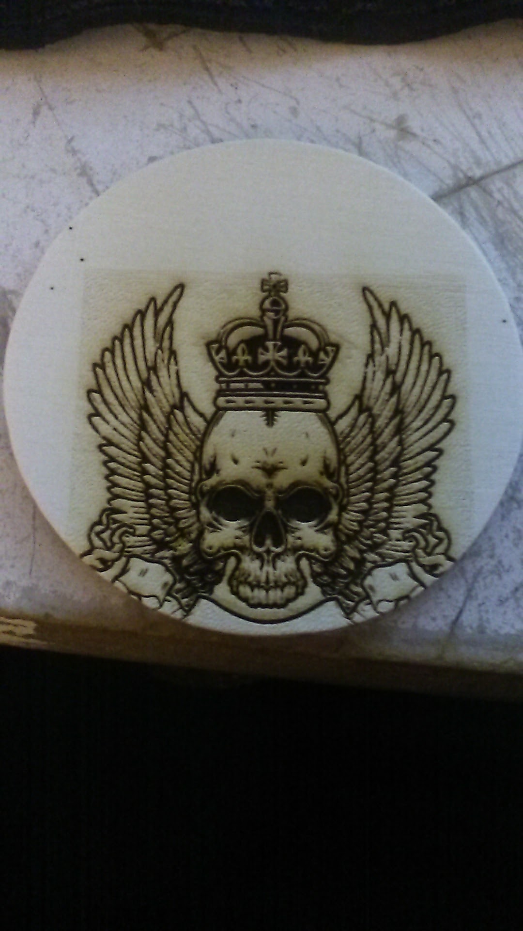

In the skull pic it looks like you had the halftone turned on because I can see the square around the image. If you turn off the halftone for images that are black and white (no grey) you should not see that. (Or make sure your background is pure white)
there’s an option for half tone??

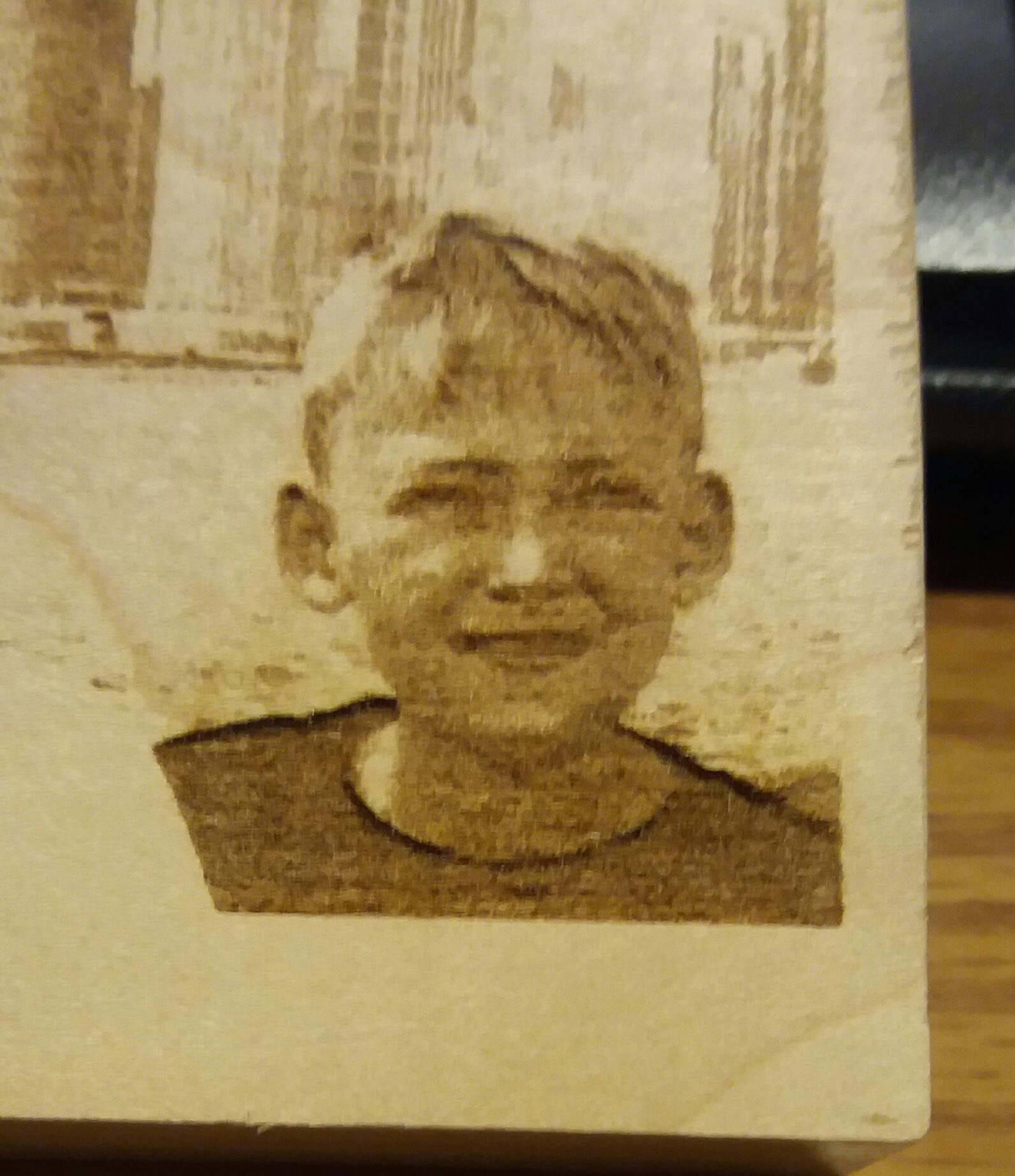

Yes, under ‘Settings’-‘Raster Settings’ I don’t have any good pictures to show yet. I want to add settings to get the “dynamic range” right. Here is a test I did with it. (the engraved image is about 1.75 inches tall)
@Scorch Thank you! i didnt even realize hahaha, Also the Raster settings do work pretty well, The issues in my engraving were more due to the Photo in use, and learning curve to having a brand new laser cutter something ive never really used before.
