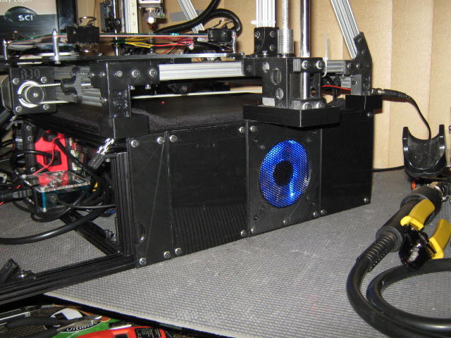

Starting to get done with parts now. The sides are done but I may land up putting another fan in. The front face is going to wrap around the sides, the rear is going to latch into the inside of the beams with some clips I have in my head yet to design.
So far the USB for the ramps is on the left rear, the psu needs a 90 degree cable, Then there is a 4 port powered hub running off the psu. The led on it was hacked and removed and replaced with a blue one on a set of leads for the front panel. There is Video in, HDMI out, and ethernet for the Pi. Then the camera jack will be on the face for the camera ramps (board I designed for making timelapses with a powershot or gopro)

Looking good. I’m trying to get some cash together to get some meters of openbeam so I can make a better enclosure. The one I have is to tight a fit, and I’m thinking of converting the i2 into a MendelMax OB1-Prism it’s on thingiverse. I could make a better inclosure around that than the i2.
And I do have a pi laying around but no screen so I have a LCD controller I would use for the headless printing. And a slimline ledstrip psu.
