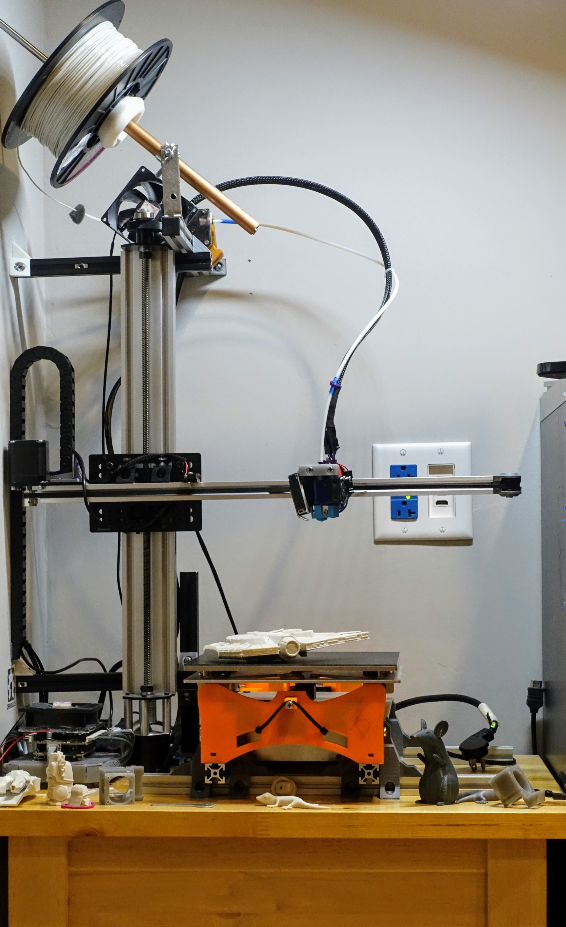

State of my 3D printer :) with overhang x axis,
State of my 3D printer :slight_smile: with overhang x axis, it is possible to get good smooth print result but to arrive there I needed to pay attention to every nut and bolt. Basically zero wiggle room. Especially the z gantry and x gantry and getting the openbuilds wheel to grip the aluminum extrusion firmly also take some trial and error but once I’m happy with the grip it is worth it :slight_smile:
X travel speed up to 200mm/s no issue. The moving y bed still the biggest limitation of this printer as I find it anything above 60mm/s print speed is starting to push the limit…
Looks like a variation of the reach 3d that I got on Kickstarter. Been happy with mine. Great learning experience.
I don’t know who started the idea of cantilever design… I doubt reach 3D was the fist though… I draw my inspiration from bukito and Indie i2
