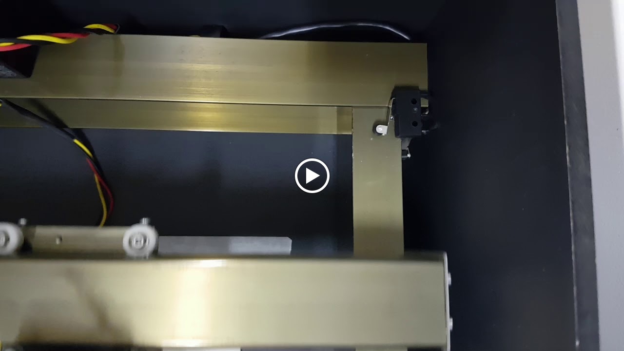

Stationary x/y homing switches for my laser engraver

This is how the switches are mounted:
Are you able to slow down the homing seek rate? I’ve run into issues with too fast causing switch bounce and non-repeatable homing
cprezzi
(Claudio Prezzi)
4
The homing speeds can be changes in Grbl"s config.h
