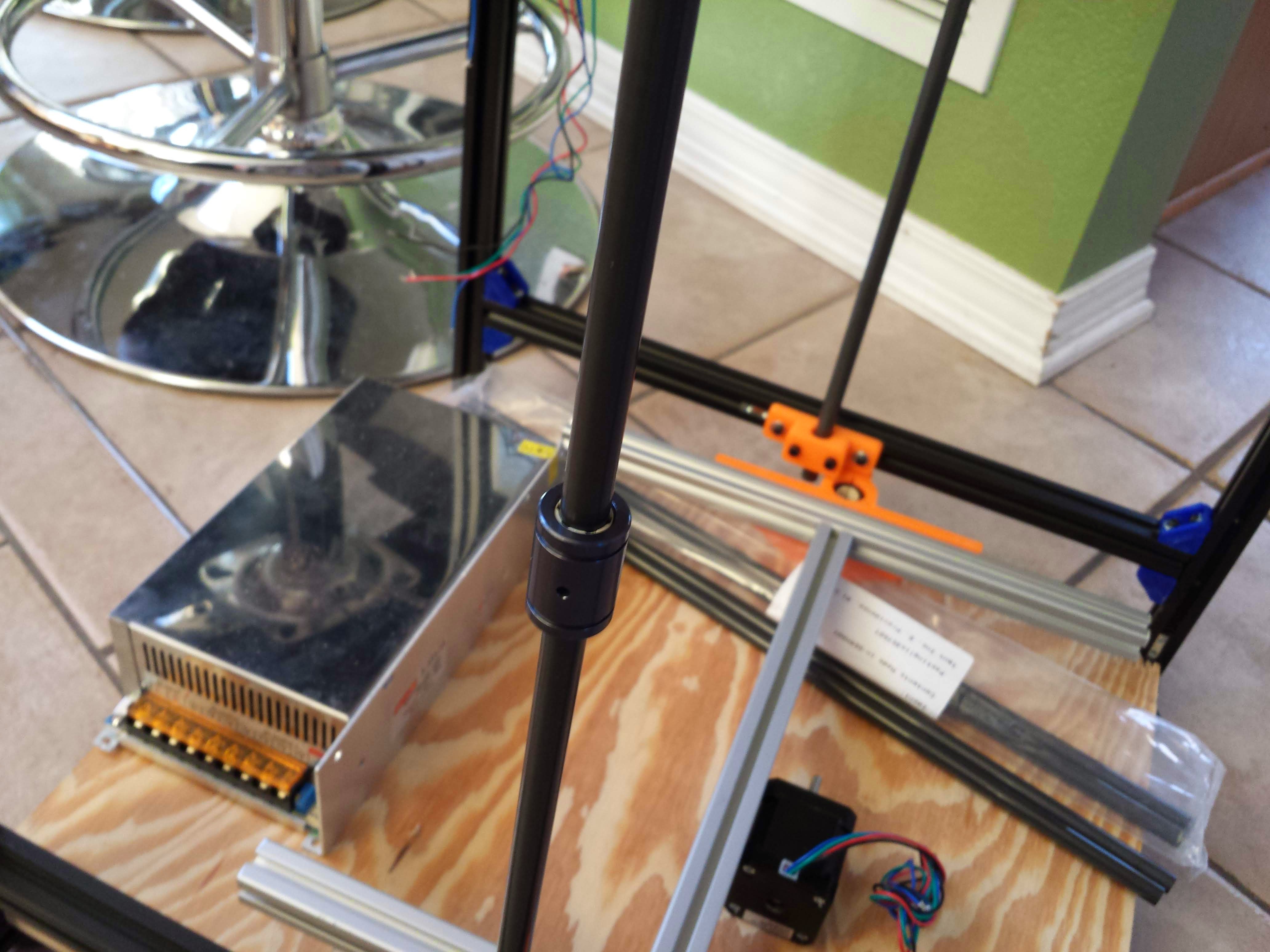

And I’ve discovered that it’s much stiffer in one direction (constrained by Cap screws threaded into the 20x20) than the other (constrained by printed 90 degree retainers). So when I get the dimensions sorted, I’ll be drilling and tapping those cross pieces.
There are some interesting take-aways to using the @igus_Inc parts in this design. The shorter bushings are slightly larger than the diameter of the rod they slide on. The bushing ID is 10.12mm, and the rods are 9.97mm. Whether this is for thermal expansion or to adjust for slight mis-alignment, I don’t know. But when things are dialed in, they’re great.
Where this dimensional change is apparent is in places where only a single conventional bushing might be adequate, these bushings really need a little more to work with. In the photo of the gantry, the axis that has two bushings for support, there is no undesirable movement. In the other direction, there is an unacceptable amount of play that would translate to the print head. I’ll be printing a replacement that will utilize four bushings instead of the three here.
@igusInc Also sells drop-in replacement linear bushings that have an Aluminum shell to make the bushing the same dimensions as a conventional linear bearing. There is no play in this part and movement is exceptional. I ordered a part with an ID of 10mm and an OD of 19mm…the ingentis parts are expecting an OD of 20mm, so I’ll need to ‘warp to fit’.
The carriage in that axis is a point load, spreading it out across two bearings should handle the problem nicely. #knockswood

@Joe_Spanier I may end up making aluminum sleeves then…that might also remove the play in the one axis photographed above.

Looks really nice, are these Misumi extrusions and smooth rods?
I could stare at the finish on those smooth rods for a while:P
@MISUMI_USA extrusions from their First150 deal, the sliding parts, including rods, are @igusInc
